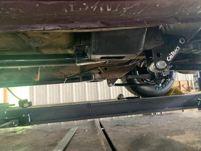

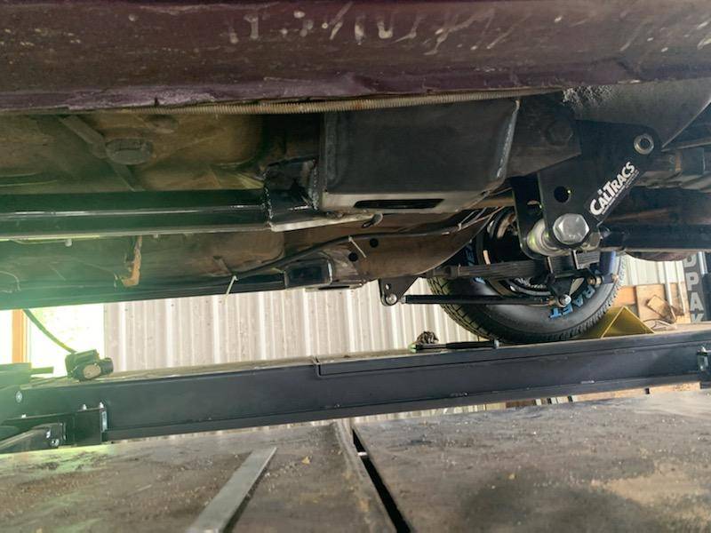

We run Caltracs on all of our race cars including my Superstocker.
I have never needed to move the instant center any more than the
adjustment afforded on them. I run them on my 2400Lb. Duster (Hot Rod
Project Car) AND my 4000 lb. Aspen Wagon O/SA. They do great on cars
that different. John Calvert's shop is always very helpful and available!
I run the cal tracs on my 69 bee w a 512 stroker i am in the mid 500's for HP with street tires and a 4 speed after some initial adjustment, most important, i can launch straight, while I still have wheel spin (on demand) but it is more important to me to stay straight..
You're making enough torque that those hard street tires will have trouble hooking. We've done some true street tire racing (400 treadwear or better) and the best 60 ft with some tires similar to yours (275/60/15) was a 1.72 with 50 lbs. of weight in the trunk and leaving in 2nd gear.
I have snubbers split mono leaf springs and I really needed them, as I only discovered by bending the top choice of the 2 pinion snubbers
offered by Mancini. I was really wrapping up the factory leaf springs, but I didn't know how worn they were before that episode.
To your question, CalTracks or Assassin traction bars? I chose the ASSASSIN bars, because their road clearance split the difference between the full size CalTracks (less road surface clearance than the Assassin bars) and the "shorty CalTracks which barely had a bit more road clearance.
The Assassin bars have trailering etc strap loops, more adjustment, and Mr Kim Smith, the owner of Smith Racecraft was helpful (as I hear Calvert staff are) on the phone.
MOST of all, I like the way the Assassin bars interact with the spring eye vs the CalTracks.
It was an obvious choice. Assassin.

Those are sweet 60's on street tires!! I am not doing any "real" street racing just stoplight stuff and I was launching consistently hard left (well a strong drift anyway) with the cal trac I have been able to correct that and am not worried about a "Mustang doughnut" when I get on it.
That's on a minimally prepped track. I should be able to get some real street times soon as I bought a Dragy for Christmas and will probably try it out this weekend.
