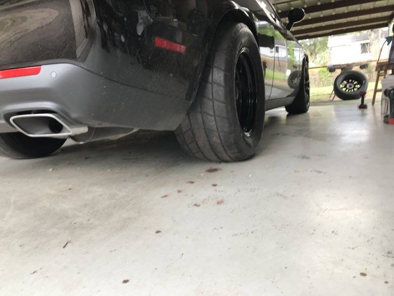

I have Caltracs with -1" split mono leafs mini tubbed with 315/60/15 Drag Radials or 29.5x10.5W Slicks.
I talked with a guy that's had a REALLY nice old Dodge 330, built RB putting out about 650HP and has an extensive roll cage, really trick rear suspension, fuel cell..looks like a track car, but really beautiful to look at.
HUGE tubs and HUGE, REALLY WIDE "street tires" in that they have tread voids across the entire width. He said absolutely NO traction on the street.
I'm going to have to find something that can get me some grip on the street, even though I may have a little more HP/Torque than he does, and with some other cars I saw that obviously had totally tricked out "track focused" frames and suspensions, they either had really wide almost no tread void drag tires that had DOT approval OR just had slicks.
I was hoping if I get caught in the rain I'd be able to slow down and drive through it, but I don't know now.

My tires have full tread Same tire that on my Charger

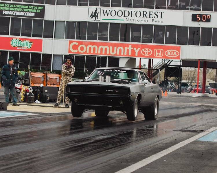

Your rear suspension components in the Charger on the drag strip pic (lifting both front tires off the track-gotta love that pic!) give me hope that there's a way to hook, on the track at least, with what I have. Thanks
It always gets hard to hook on the street. At the track, even an unprepped track is stickier than the asphalt which does not have a smooth surface. It’s closer to lots of pebbles all at the same height.
I do wonder about the few cars that I have seen on the street that pull the wheels up high though. I remember seeing some guy in a 90’s Mustang pulling the wheels up more than 2 feet high. Quite a sight.
