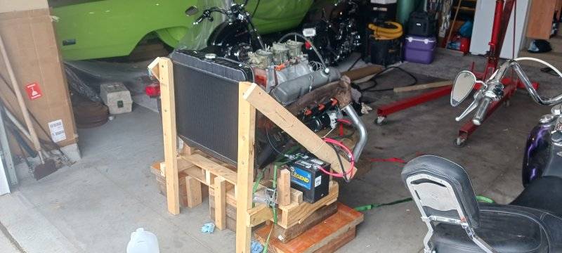

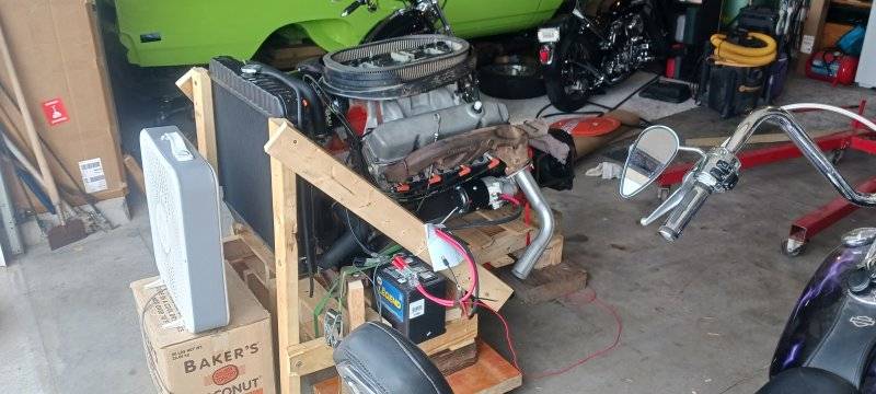

The day finally came to fire this thing off! I thought I checked everything over 10 times but it didn't start immediately. Oh, yeah, I forgot to put the coil wire on after checking for spark! Then she started instantly! Wow, I did a few things right! I had filled it with distilled water and it started boiling over reaching 230 - 240 degrees so I was definitely getting nervous! I was cooling it down with a garden hose and bam! The radiator hose blew off. So I shut it right down. It soaked **** 20 feet away in my garage. Damn Corbin clamps! I was a bit leary about using them for this. Anyways, I got about 10 minutes run time and no leaks so far. The wooden run stand was rock solid! Success!!!
THIS project is total redneck and I really dig it.
Engine run stand sponsored by Home Depot, exhaust system inspired by annoying neighbors that don't appreciate hot rod sounds and a NAPA brand battery just for good measure.

Tip put a big blower in front of the rad, i bet it will be cooler next time you start it up.every one should do just that.
