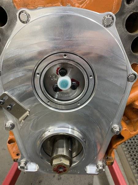

I use the Teflon roller button and just notch the button for clearance on the three bolt heads i use the same ARP cam bolts with no problem. Are you using a cam button that’s attached to the timing cover? The attached pic is the
setup and works with a stock timing cover.

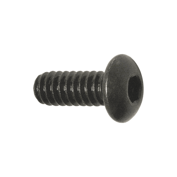

Button-head cap screws.
You don't need anything fancy or high strength for these , the cam pin and the cam itself keep the sprocket situated - the bolts merely secure it and are fairly low torqued.

The torque specs are 45 pounds for the ARP bolts. I wonder how much you could torque those button heads.
I don't know why you'd need ARP bolts for that application - especially with the grief they're causing you. Stock torque spec for a single-bolt cam is only 35 ft lbs - why they'd call for 45 on three bolts is beyond me !! Regardless, you'd have no problem torquing those buttonheads to 45 - they are a high grade bolt.
Agree. The button heads are grade eight, more than good enough for your app. Just use a quality driver/socket.
