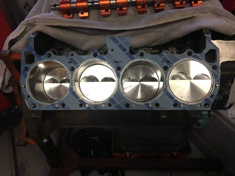

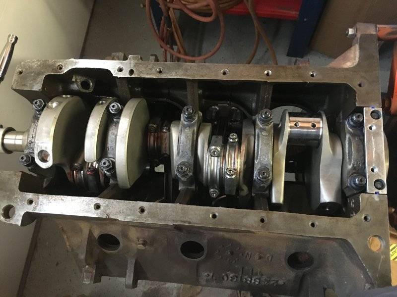

I did a 451 inch 383, used 3.900 crank with BBC journals and 6.700 bbc style h-beams. You could in theory offset grind 440 crank to same specs. Used off the shelf diamond 51950 pistons designed for 3.75 stroke. Keep in mind that more stroke = more compression. This one is about 10.5 with stealth heads. On the rockers, if you want good geometry on the valve tip, get Harland sharps SHPS70016KE or SHPS70015KE rockers for Edelbrock heads, then have custom length pushrods made for your combo. Also get PAC beehives if you need springs. Good luck with your build!
