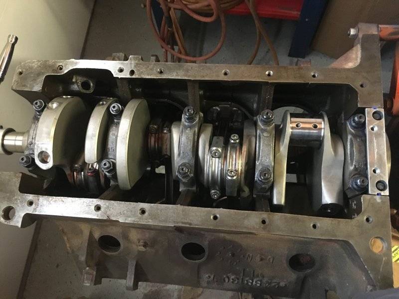

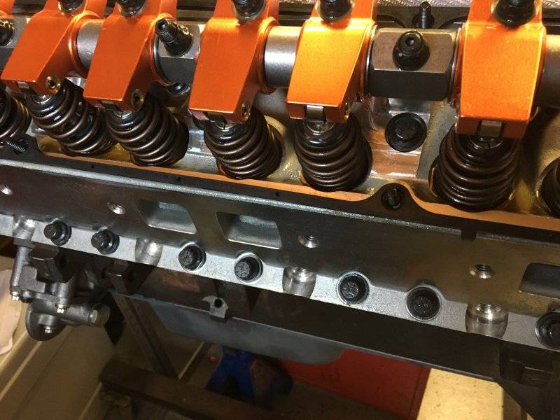

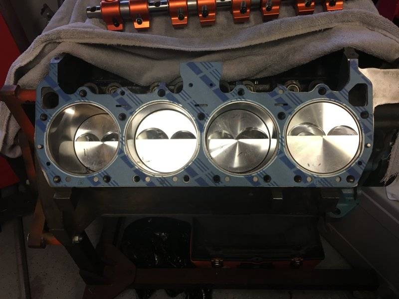

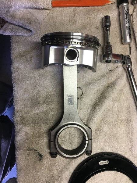

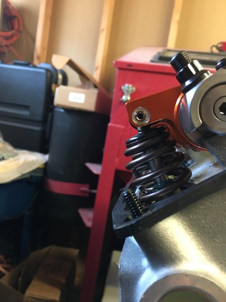

I really wanted to go with a 3.9" stroker and Muscle Motors sold a 383 kit for it. Unfortunately, they are no more. 440Source lists the crank but won't sell a kit due to lack of pistons they say. I thought they had their pistons made for them so why can't they just order 3.9" crank compatible pistons? Who knows, but unless I want to piece the parts together myself, which I don't, I'm left with 432 or 489 kits and nothing in between. I can work with that and will be deciding soon which way I'm going with my 383. Thanks for all the great pics!I did a 451 inch 383, used 3.900 crank with BBC journals and 6.700 bbc style h-beams. You could in theory offset grind 440 crank to same specs. Used off the shelf diamond 51950 pistons designed for 3.75 stroke. Keep in mind that more stroke = more compression. This one is about 10.5 with stealth heads. On the rockers, if you want good geometry on the valve tip, get Harland sharps SHPS70016KE or SHPS70015KE rockers for Edelbrock heads, then have custom length pushrods made for your combo. Also get PAC beehives if you need springs. Good luck with your build!
