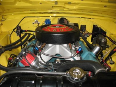

Cam is in, car is running, now the TUNING begins!

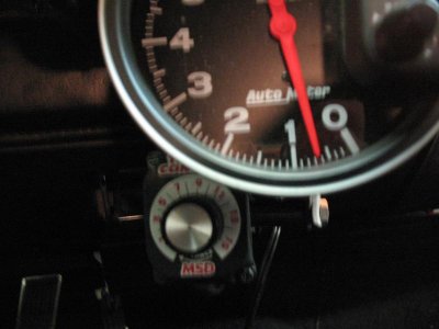

I agree with Jim @ Racer Brown for quench as I have a 440 4.15 stroker decked .020 zero deck . Ross pistons .040 bore estimate 11.2 compression,ootb rpm heads,hydraulic flat tappet cam .525/.521 lift, 244/256 @ .050 cam,holley street dominator,950 quickfuel, msd pro billet dizzy and msd 6a,2" TTI headerinto 3" exhaust,SMR 3000 converter ,Dana 60 373 gear, no detonation with 94 octane pump gas .It does ping with 91 octane under very " hard " throttle but I have an adjustable dial timing control mounted on the tach to retard when this happens.Running 18 degree initial,34 total, all in by 3000 (using the black 18 degree bushing 1 silver light and 1 blue light spring).Best ET to date is 11.70 @ 116 mph. I,ve just installed the Fast EZ efi and just need to fine tune,my buddies say I shouldn,t touch it as it runs too good...lol
