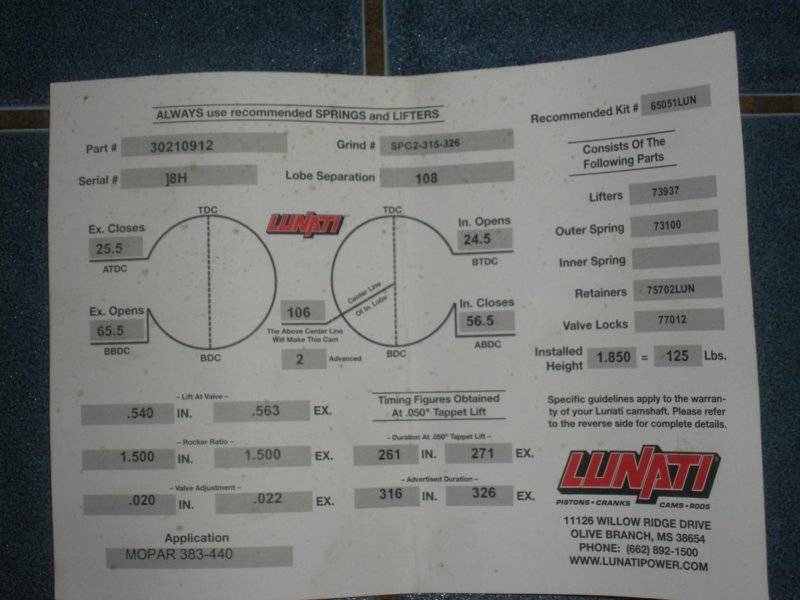

Second cam was the Lunati solid 316/326:
A pretty racy cam but it didn't help stop the knock.
