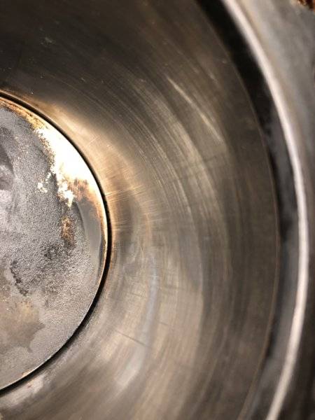

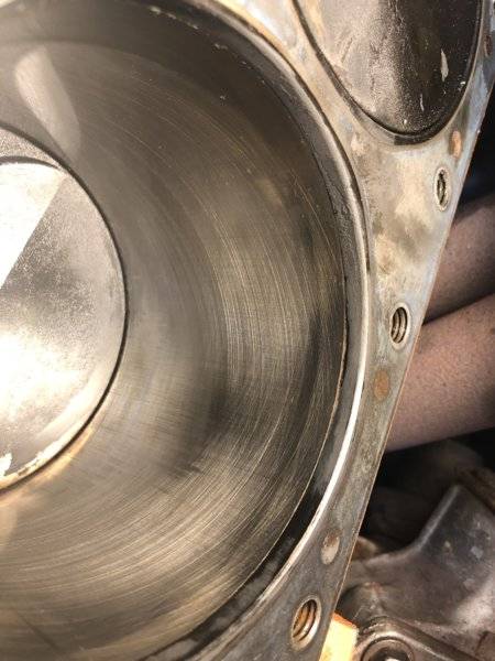

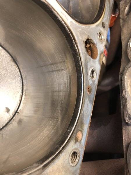

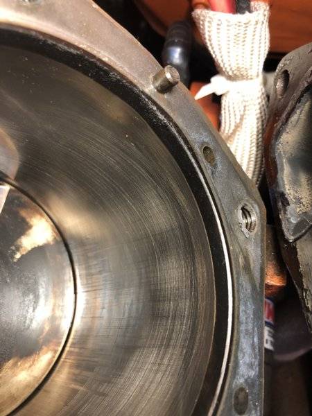

I recently removed my Racer Brown Cam .510 .241 and installed the Lunati .268 Voo Doo hydraulic cam in my 440. I broke in like I do every other one, in same motor. Now I have 5 wiped Intake lobes.
I know I have to tear down and clean. My question is, can I get away with the scratches in the cylinders or will it have to be re honed? I have attached pics. One is in #7 are the most notable, if you run your finger nail across them you barely feel them. The pics are in order on the left bank 1,3,5,7. The engine has maybe a 100 miles on it since build last year. Let me know, Thanks
3888A237-FB60-47B4-9140-A23C9ED57713.jpeg A5B26143-FF8B-4933-A82C-30006CB5789E.jpeg B5EBDF60-8635-46BB-A603-0CCC66B430FA.jpeg 28A1BF6D-9D37-4EC8-BF2B-CBB3DDC61CD0.jpeg
A quick hone wouldn't hurt. You gotta pull it apart anyways, to clean the trash out off all the oil galleries. Pull the cam plug from the back of the motor too, alot of grindings stay there.

Deglaze cylinders with a ball hone (NOT a rigid 3 fingers of death glazebreaker). I use Joe Gibbs Driven assembly grease for the cam and lifters, and us their BR oil for break-in of the cam. After break-in, continue to use a high zinc oil such as Joe Gibbs Driven HR1 oil.
Ok I’m just worried about Pistons I don’t want to rebore those are JE Pistons. So is this something I could do from home or take to machine shop?
It will cost about $65 to $85 for a ball hone, so it would be advisable to take it to a shop. I charge $20 to do it, and $25 for the wash.
