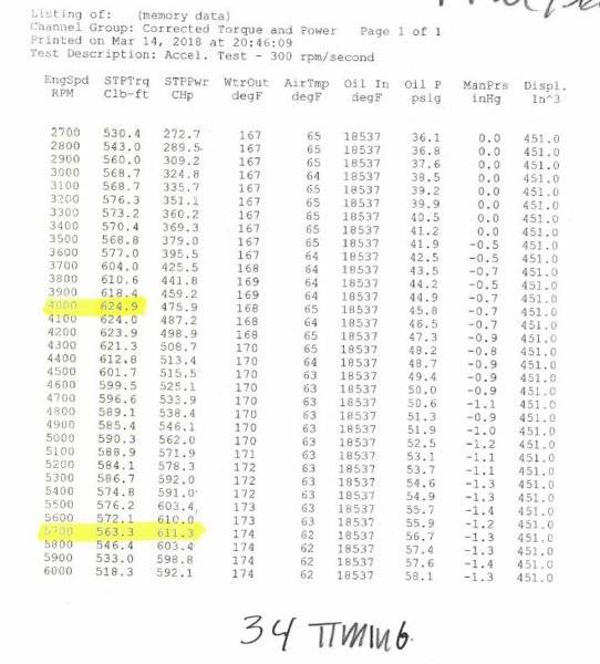

I also have spoken to both Bob K and Dwayne and I would say both are really amazing people. I have seen and read the results of a stock looking engine and BoB K is a very great person spent all the time talking to me was very thorough. On the other hand Dwayne is pretty much the same helpful attitude and informative as Bob K but from what people tell me perhaps more in tune with non stock builds. Either one of these 2 great engine builders you will not go wrong. In the beginning of this thread I liked the comment "Chocolate or Vanilla" it was right on. I myself have been dealing with Tom @ TK Race in Montreal 514-920-0094 for a long time ever since his days with Ray Barton and I must tell you top notch performance and the same type of helpful advise, Heck my 451 with a mild 236 cam he specked out and TFS240 heads made 613HP and 625 TQ and in a 79 Magnum propelled it with street tires to 11.68 118 mph so I was very happy.

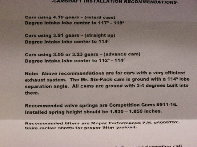

Yes I degree Bob K cam...
My car use 3.23 gear, I advance cam to 112*
Yeah I'm interested in that to if you would be so kind.
Bob's camshaft specs aren't published or readily given by those who know. I personally don't have the info, but here are three hints below...

"Karakashian learned well from his mentor Tom Hoover. In doing so, he also accepted Hoover’s philosophy of freely sharing information. Speed “secrets” are not kept close to the vest, but openly shared with those willing to listen and learn. Karakashian’s first rule governing 440 Six Pack performance is not to over-cam. Most enthusiasts love to hear the rump-rump of a long duration cam with lots of overlap. He has found this to be counterproductive when running in a pure stock class with stock exhaust manifolds. Karakashian’s suggestion is to use a factory restoration cam. He has also experimented with several custom grinds that match the pure stock rules. He has installed a fairly conservative grind cam in his Six Pack Super Bee. He also suggests running the cam in the factory position or slightly retarded. Advancing the cam will add to the 440’s already powerful low-end torque. Karakashian suggests a 0 or –2 degree setting when installing the cam." - https://sixpacksixbbl.homestead.com/mrsixpack.html
