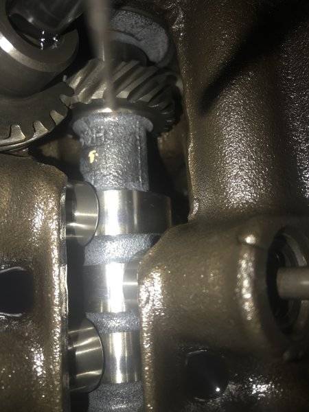

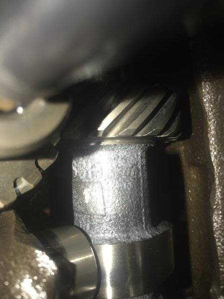

Hi Just looking for a camshaft ID. Camshaft is still in the block at the moment. All I can get from it is “SCH 55”at the front end. Rear end has USA.
The shaft is grey.
I’ve tried looking up SCH but nothing comes up.
Any info would be great

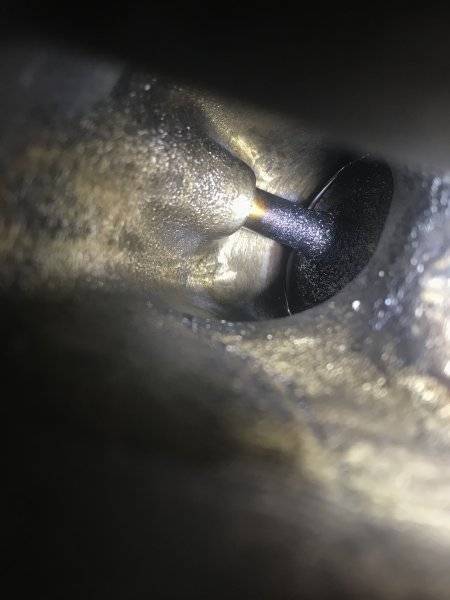

Looks like maybe the valve seals are leaking oil onto the valves.
That is the moniker of the cam core manufacturer, not the cam grinder. CWC is another common one.
Not all cams are stamped with specs or part #s, maybe just a code for the company. If it does have grind info, it is usually on the rear cam journal.

Cam ID info can be on either the front or the back of aftermarket cams. I don't recall OEM cams having markings.

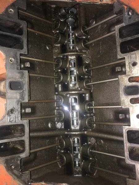

Sorry, can't really answer the direct question.... but (if it's not just my eyes lol) those lobes and the distributor gear look narrow, very narrow to me. If you want to know the real details, dont tear it out, just put a dial indicator on the rockers for the lift...you can figure out the duration too, but a cam wheel would make that easier....you could make some pretty good guesses by just turning it over and marking the damper to learn the start (open) and end (close) events...

What does the narrow lobes indicate?
Narrow/wide lobe means nothing. Just different manufacturer.

Check on the flange face of the cam, behind the chain gear.
That's were I found the part number on mine.
I had spend a lot of time trying to get the cam specs by measuring timing and lift, while I was 1 bolt away from knowing exactly what cam I had.
