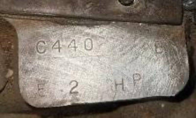

1) What is the engine assembly date (EAD) stamped on the pad in front? Thank you.

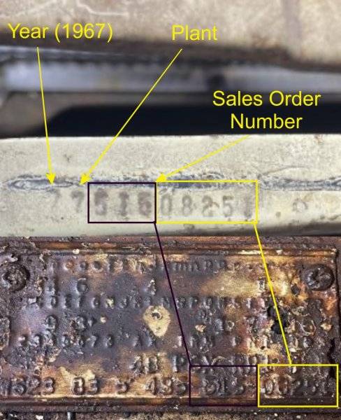

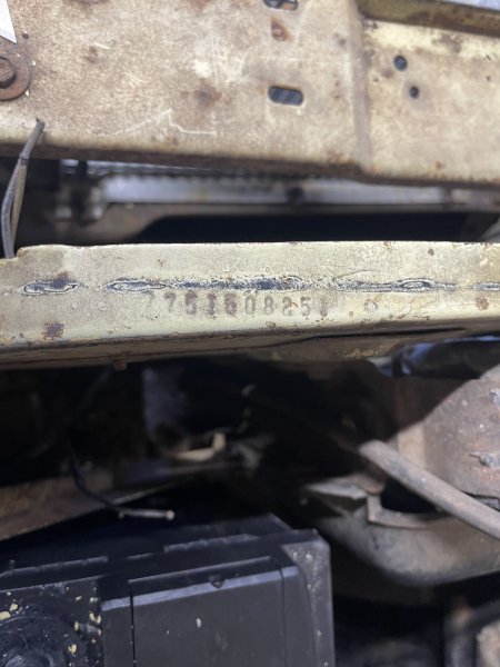

2) Clean up the fender tag so we have a clear viewing of the SPD. Is the date in fact 515? Take it it off and flip it over if necessary.

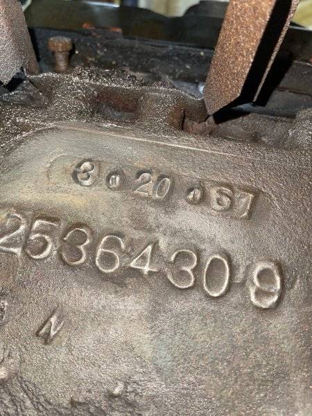

You cannot have a casting date AFTER the assembly date. The EAD of May 2nd fits very well with a 515 (May 15th) SPD. (frankly, this is what matters if you are looking for an engine that is supposedly original)

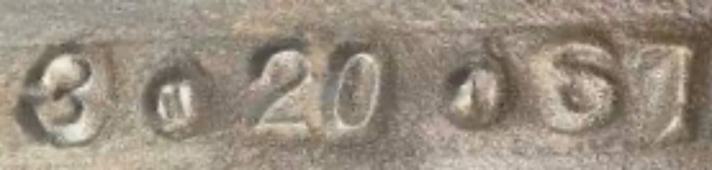

Casting dates can look wonky. It's far more likely you are misreading the casting date. Please post a picture of what you see.

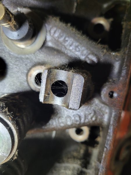

Well the heads do have cast dates, as well should have a large H P on one end
3 20 67 cast date
5 2 engine assembly date
515 SPD
All looks good.
Great. Now check for the large H P stamp on the end of each head, and the casting date ( as shown, opposite of the casting number)
