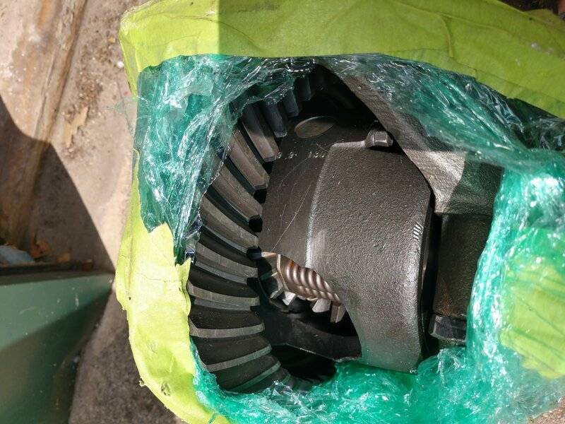

This is the only pic I've got.....time is a bit limited as I am about to head over to see it in person. Thanks in advance yall.
Looks like a clean clutch Sure-Grip. Good one to have.
Not disagreeing...just trying to clarify...that's why I'm asking questions of yall.
Thanks again.
In my opinion, it's a cone. Now, aftermarket or factory? I think probably Auburn.
Edit: clutch bolts together with bolt head opposite the ring gear. Cone style bolts together from the ring gear side.
Factory cone suregrips CAN be rebuilt, contrary to some opinion. Auburn says theirs cant. I'm not sure I believe them.
If the price is right, i say go for it. However, I didn't like the cone type for my bracket car with slicks, so I bought a Detroit locker. Street car with street tires, that's what the auburn is made for.

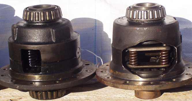

"I've got a couple of Sure Grip units which are both cone type...

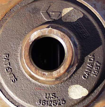

The logo here might help with one of them:
Marked 'Canada' and '1987' could also be a clue.
If anyone can help me to identify these I'd certainly appreciate the help."
__________________
Answer...
The unit on the left is a factory cone-type, the one on the right is an Auburn Pro-Series differential.
The one on the right, that ISN'T disassembleable, has the auburn logo on it. The other is the rebuildable factory cone suregrip. The carrier unbolts from the ring gear side.
