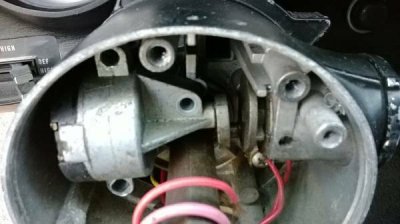

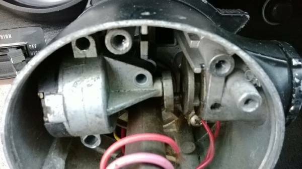

I was trying to do this quickly so I could move the car and kinda rushed into it.
Now I have to because I sold my house.
:icon_frown:
The car is now steerable for flatbed purposes but makes a terrible grinding noise.
(the bearing seemed fine?) I still haven't found a 11/16" nut.
Mike..
If the grinding noise seems to come from when you steer, check under the hood following the steering shaft into the housing right before the firewall, if you lowered the column and didn't get all the bushings lined up, washers etc, it could be riding high into that housing at the firewall, a quick inspection will tell, then you'll know you need to re drop the column and make sure its bolted up correctly, just one idea to look at.
