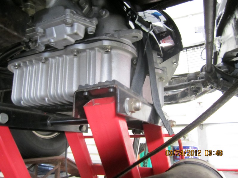

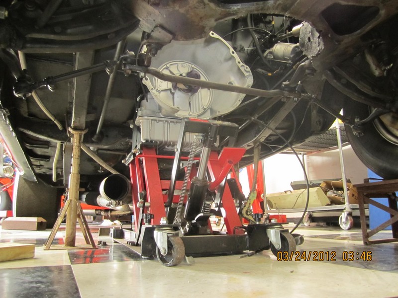

:eusa_whistle:The HF trans jack is nice to have
