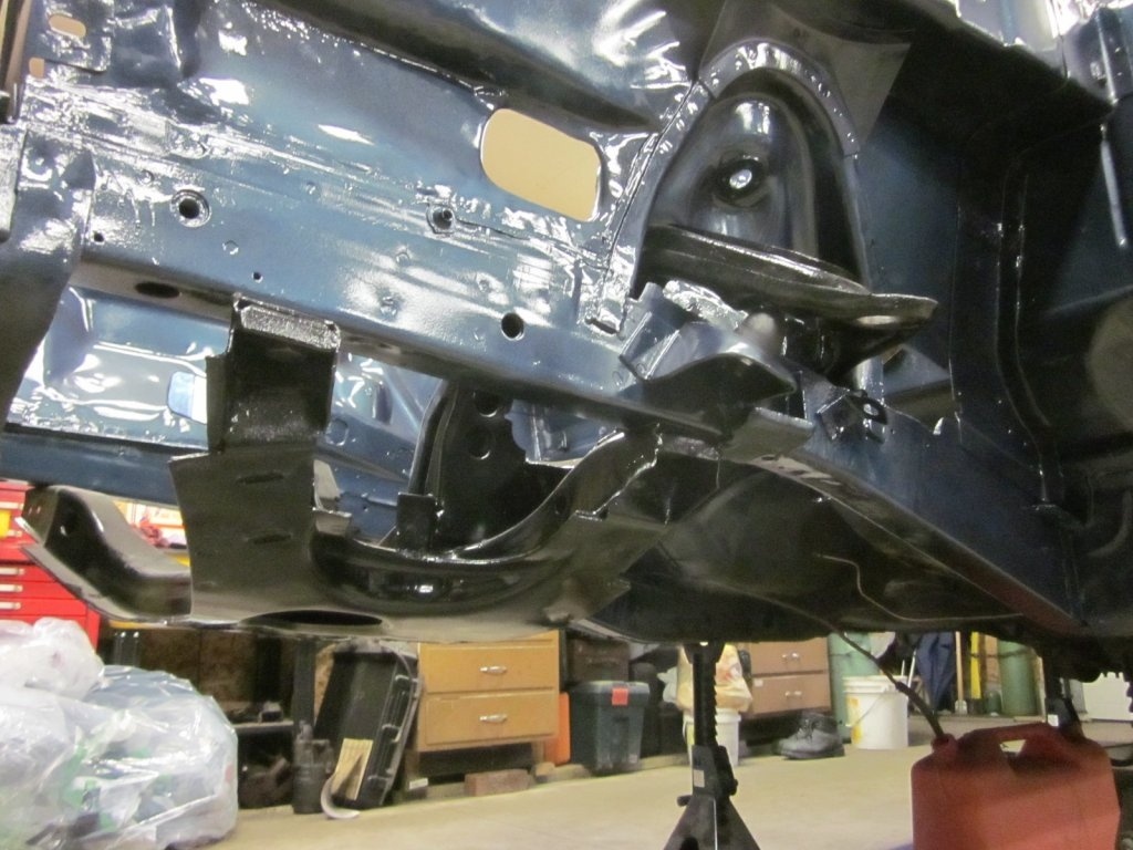

Can of rusty worms
Glenwood, you need to stop cleaning stuff up or you will keep finding problems lol.
Looks great, every step is closer to getting her on the road.
As for the torsion bars, I am sure you can do the floor with them there. Just make sure not to cut close to them during tear out and keep them protected from welding splatter with thin aluminum or something similar.
I know I have to stop digging threewood. I must have ocd lol! At least the front end is looked after.

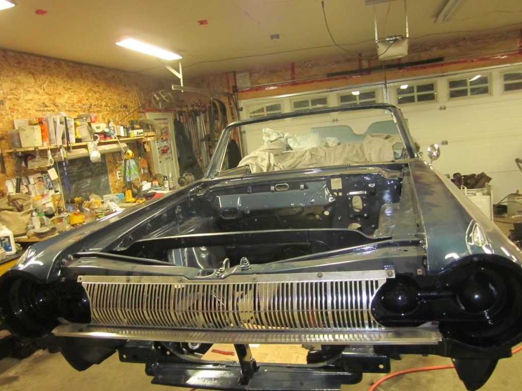

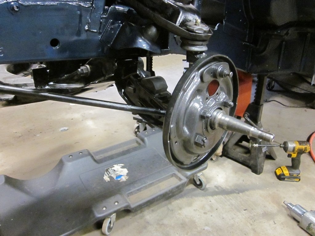

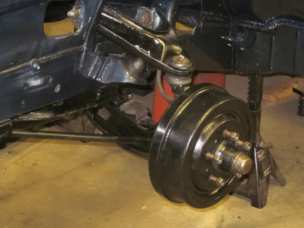

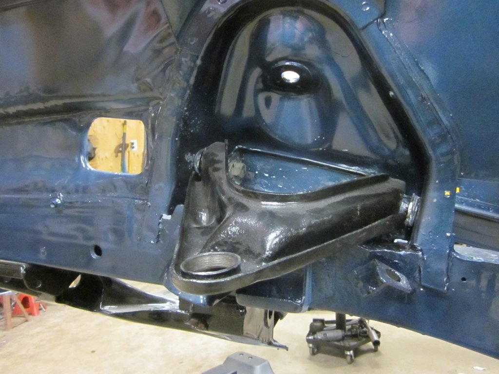

Time for some assembly!

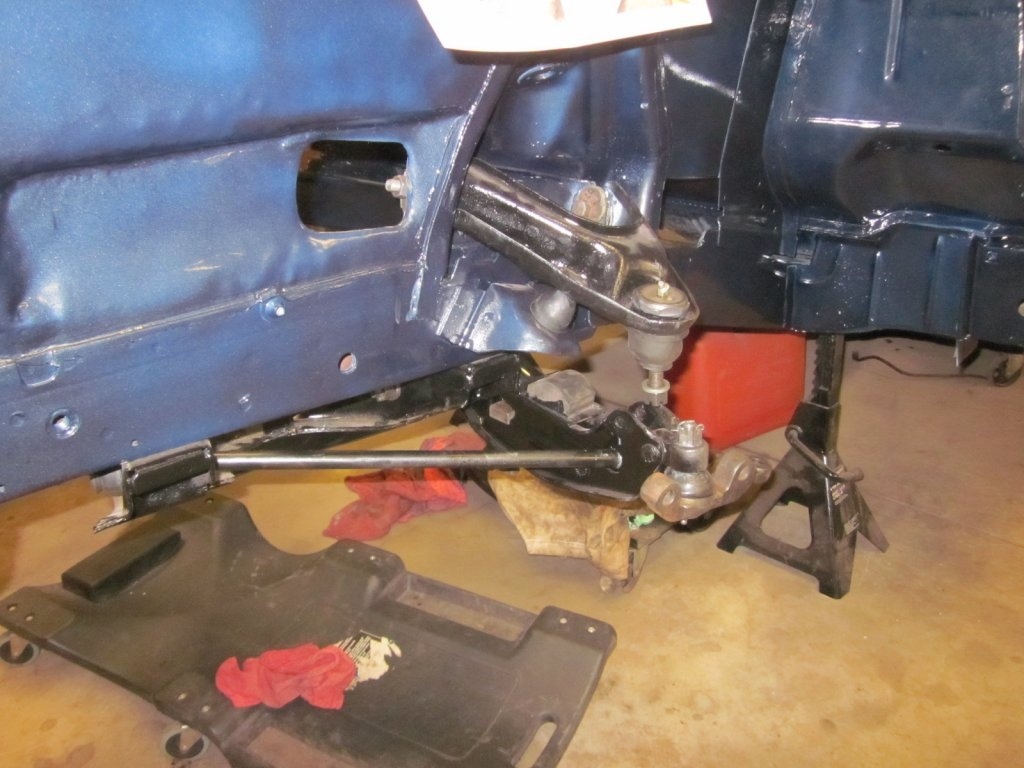

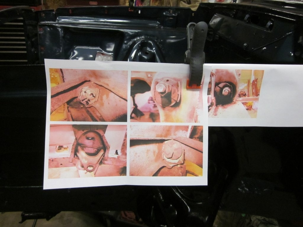

I marked the cam positions so I could get them close to where they were. Glad I took photos here, came in handy.
Looks a little cleaner now!

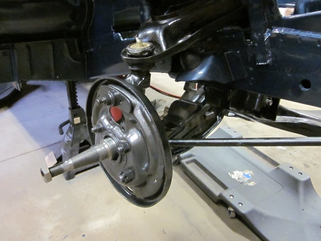

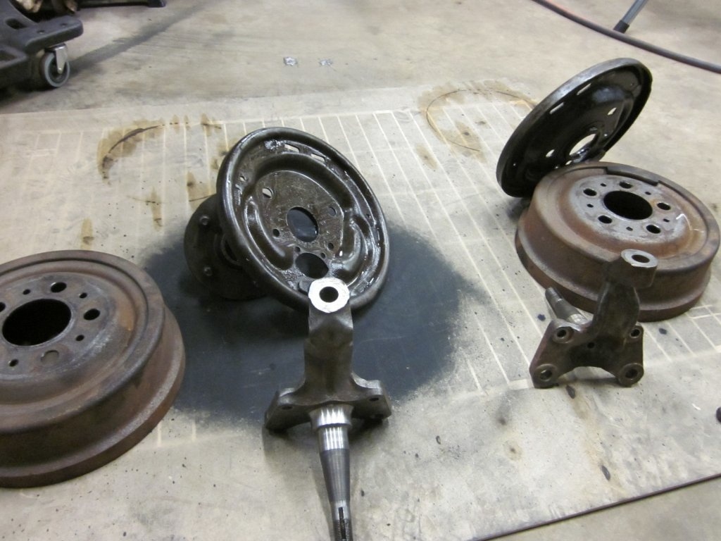

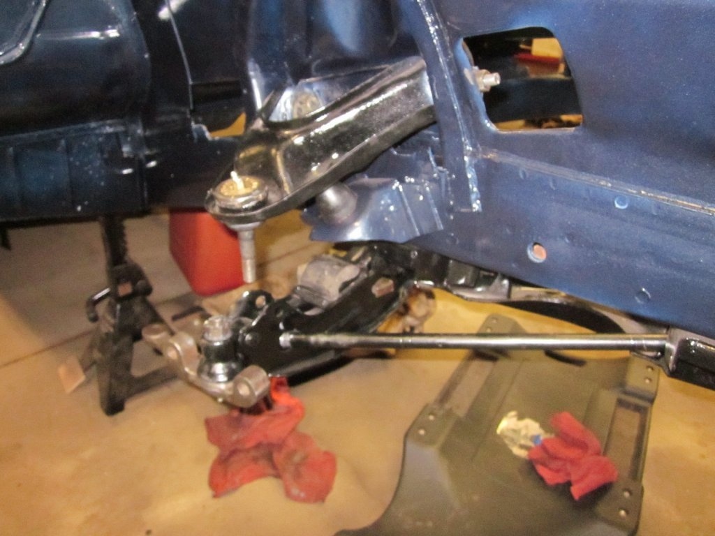

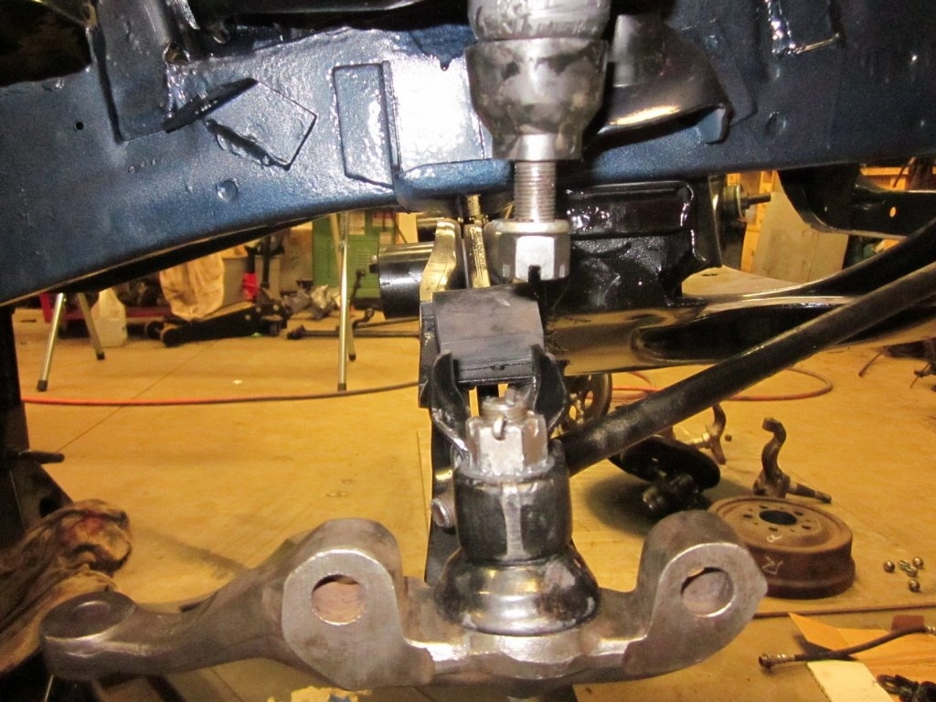

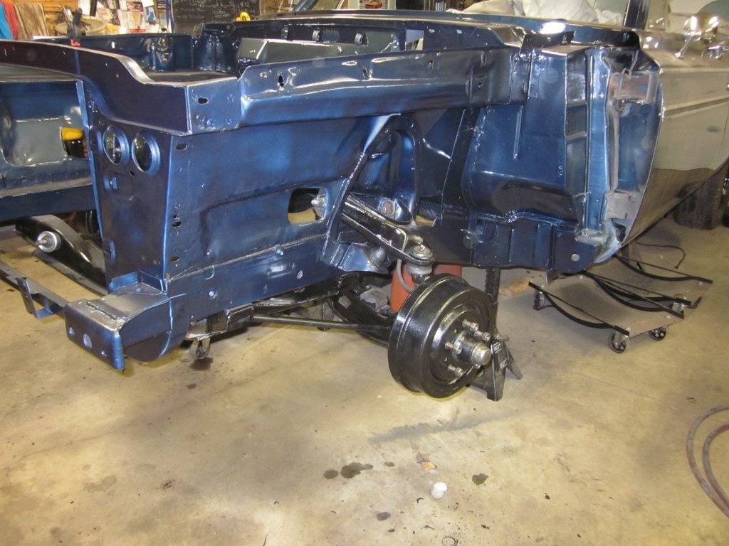

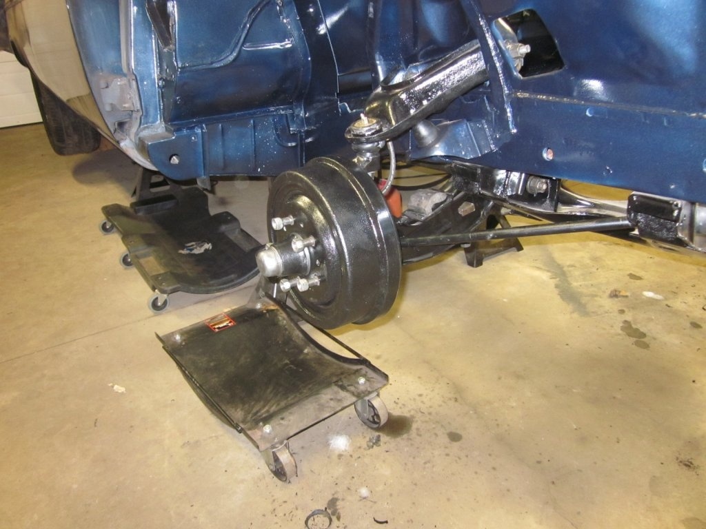

Wondering why the ball joints don't seem to line up. Must be an optical illusion as the knuckle is not offset...
Cleaning up 50+ years of crud!
Don't forget to paint the sides of the radiator supports semi flat black.

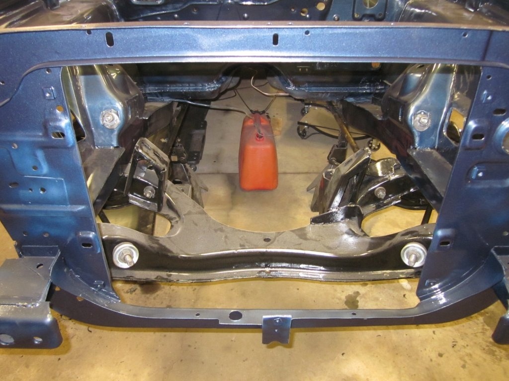

Get some padding to protect the paint when you slide the engine back in. Your work looks killer!
Might be the slowest engine install I've ever done! Thanks for the kind words Carl.
RC, I was thinking something in a pearl white might work lol

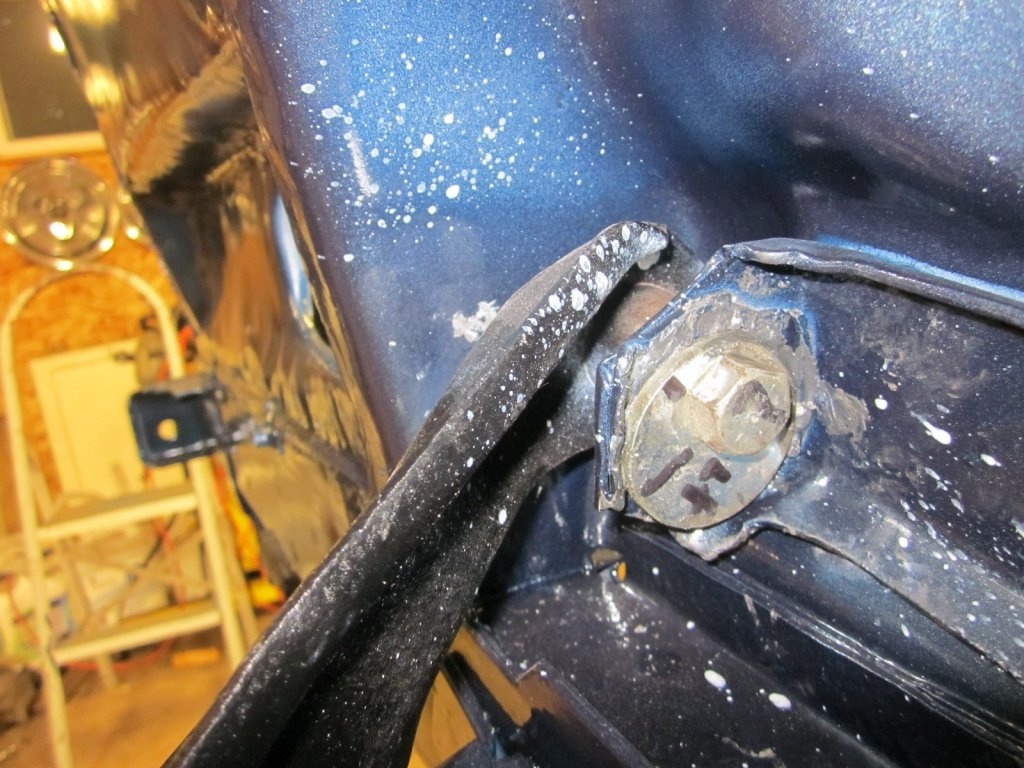

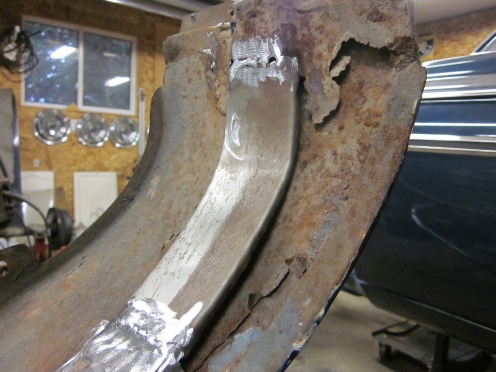

Had to do a little repair patch on the backside of this fender to reconnect the support. The fender needs to have the lower section cut off and patched but that means a repaint so this will do for now. I prefer to find a clean fender if I can.

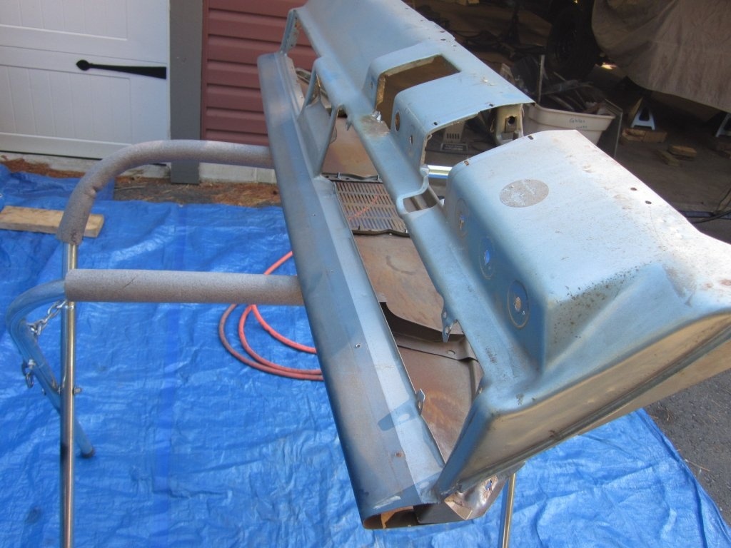

Fitting the fenders and loosely fitting some parts together.

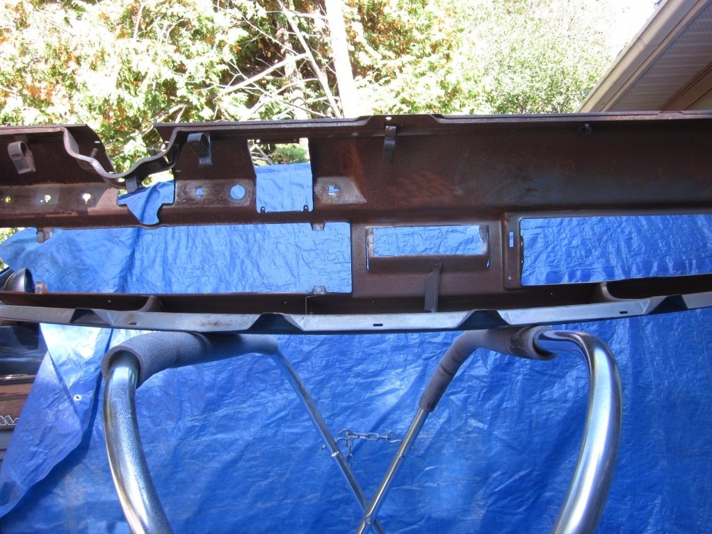

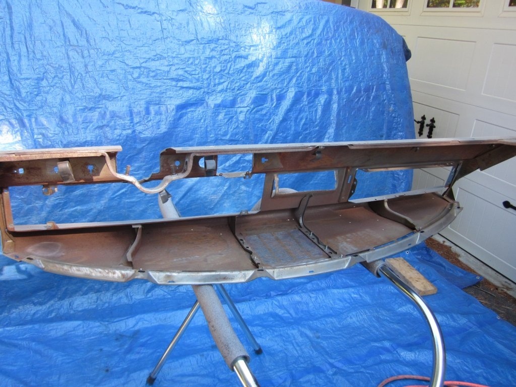

surface rust inside the dash is crazy. Must have been a lot of moisture in there over the years.
Getting ready to blast inside the dash.

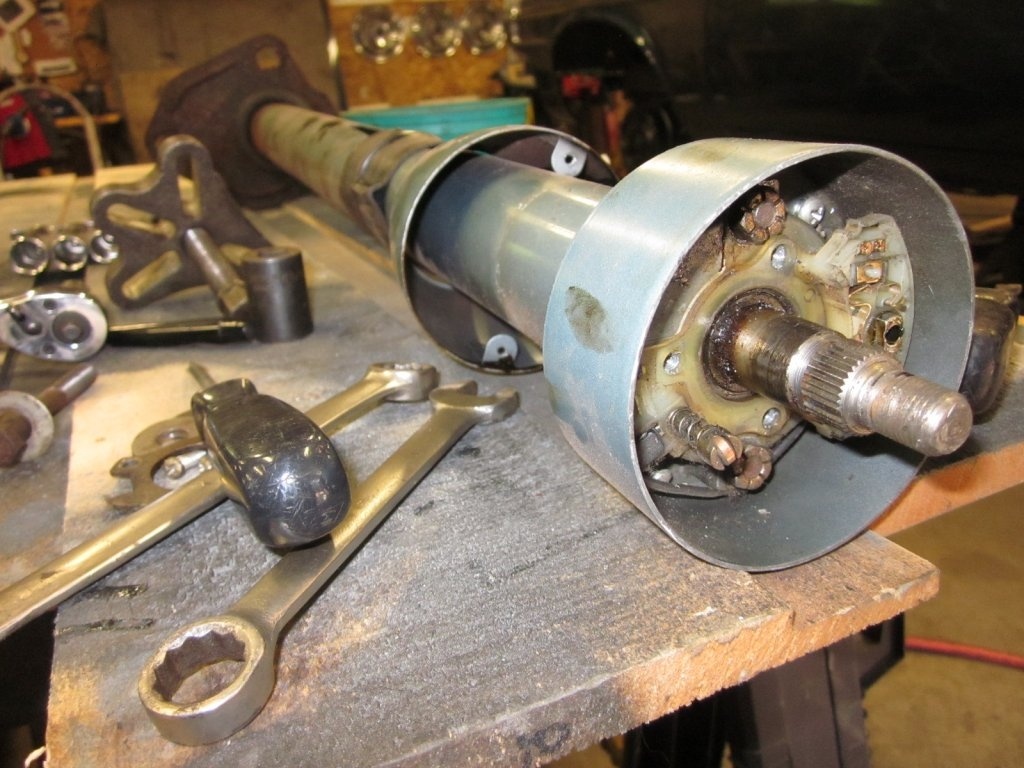

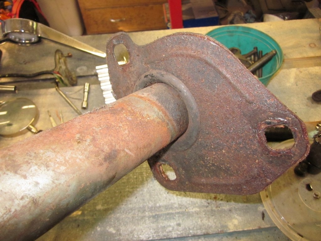

dismantling the steering column to blast and paint. Pretty rusty near the steering box.

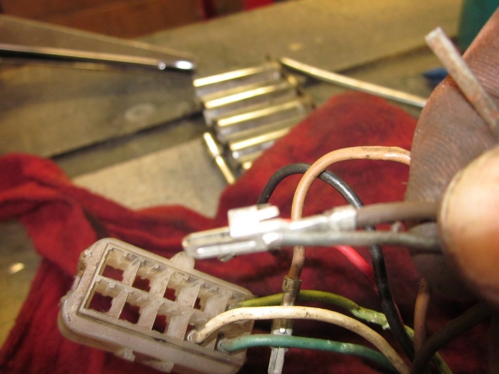

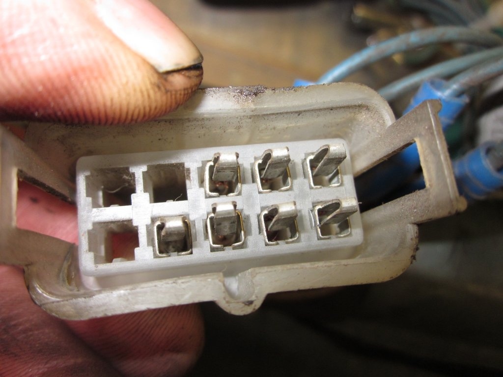

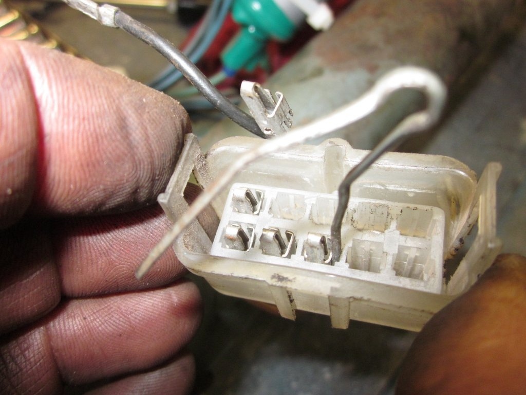

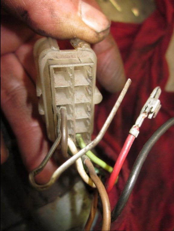

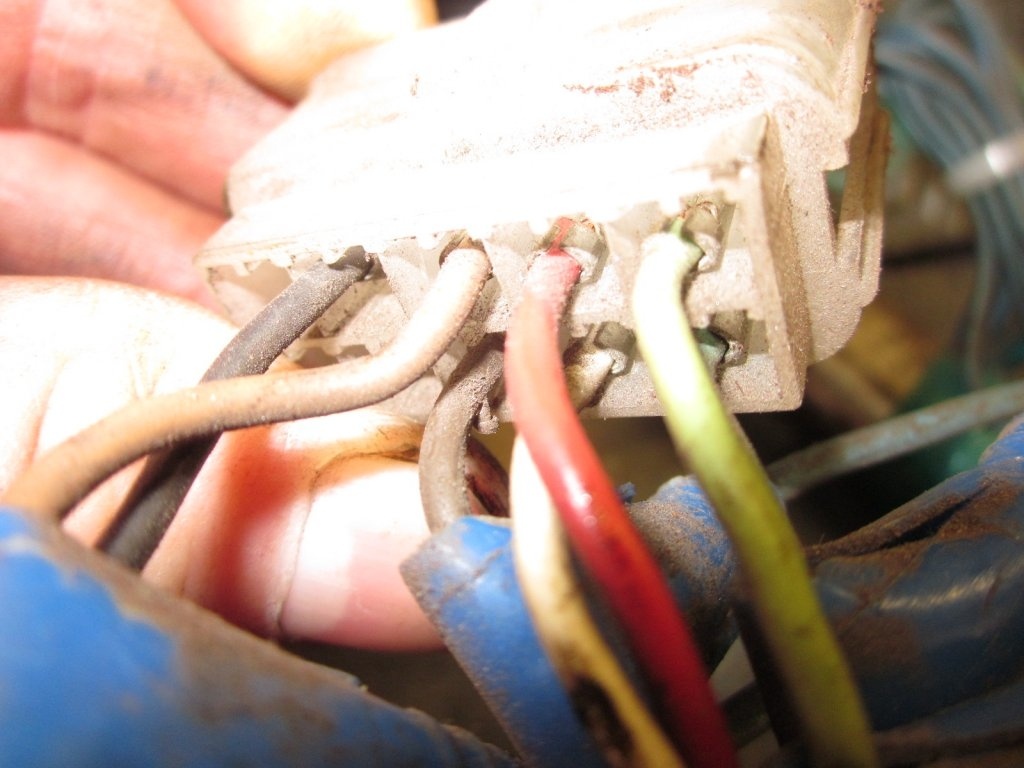

To take the column apart, the wiring has to be removed.
To remove the wire terminals, you need something small and fairly flat to push in the 'hooks'. An old cotter pin works like a charm. Three places to push in, both sides from the front then one from the back under the terminal and slide them out together.

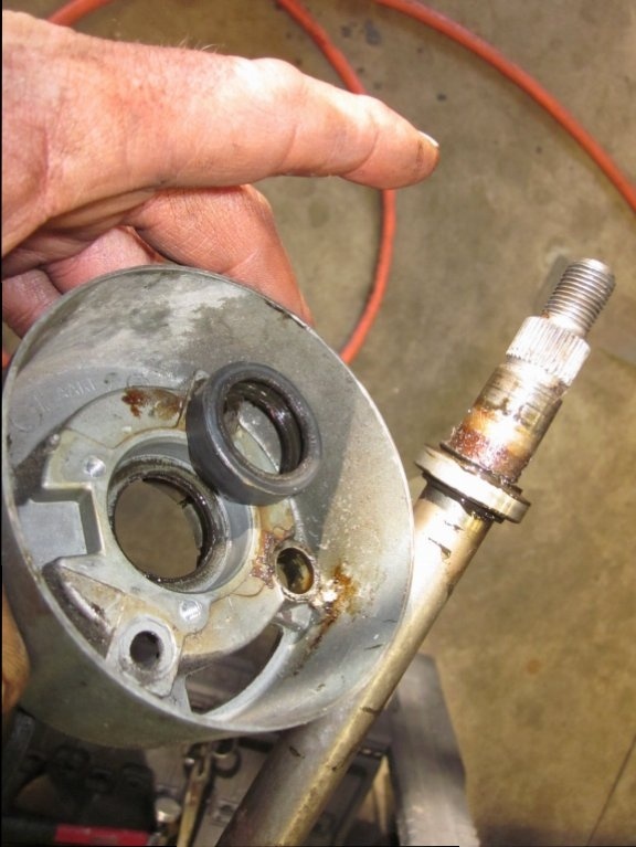

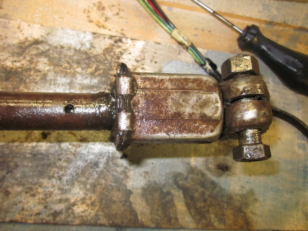

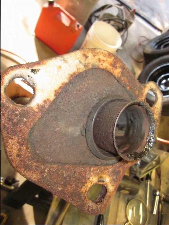

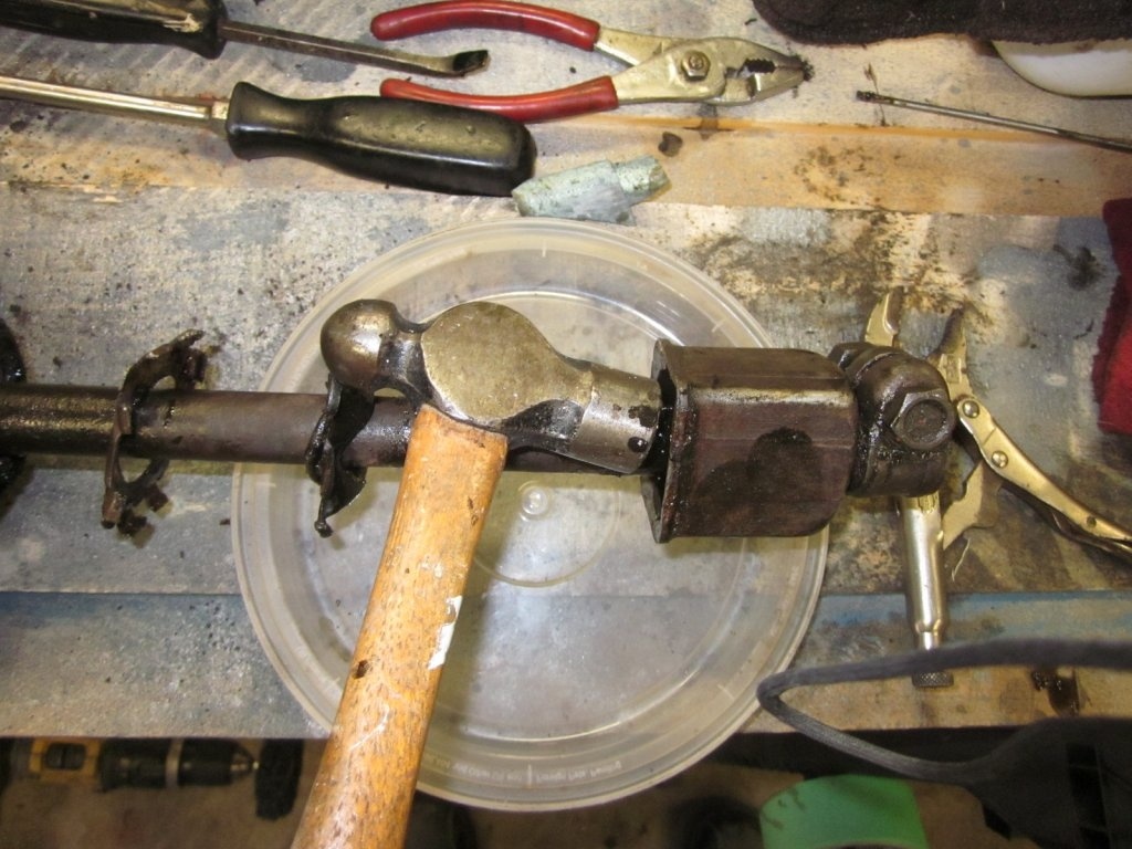

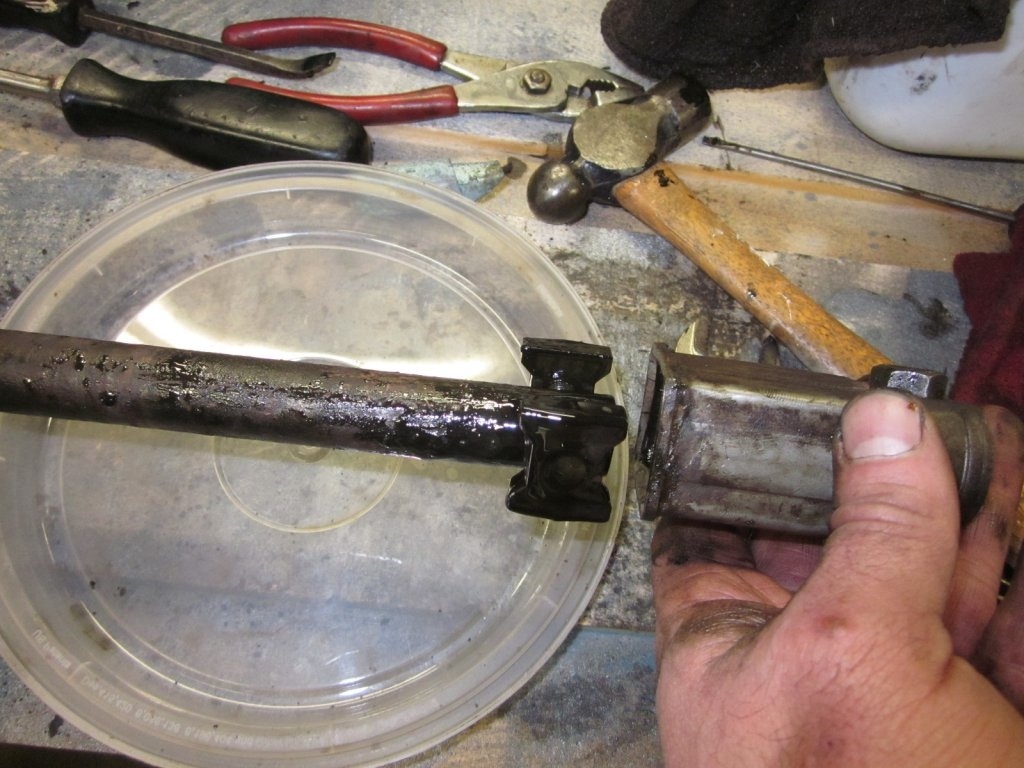

The coupler will have to come off to replace the lower seal and dismantle the column tubing.

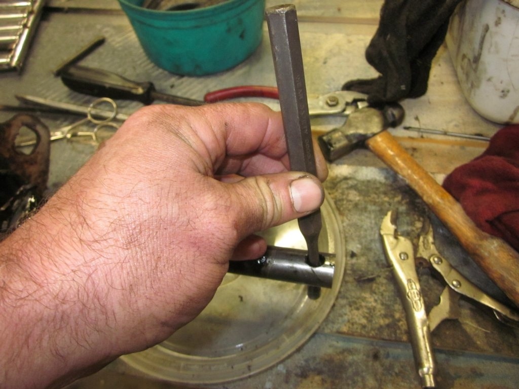

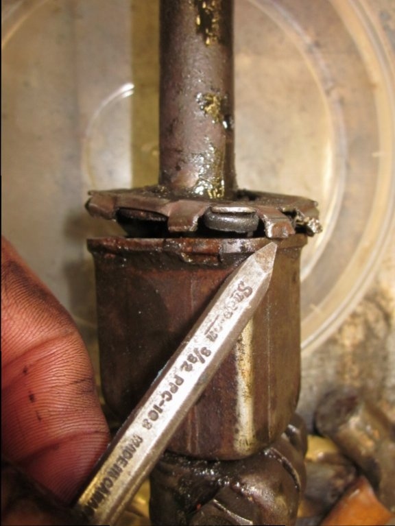

I used a small chisel to pry the lid off. Then used a small hammer to lightly tap the housing off.
Punch out the pin.

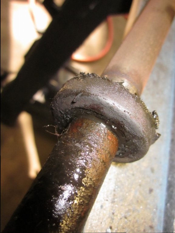

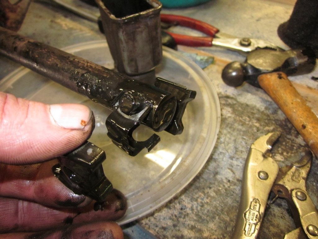

This lower seal has seen better days!
The upper collar wiggles off the bearing without too much force. Didn't want to pop off at first but twisting helped.
