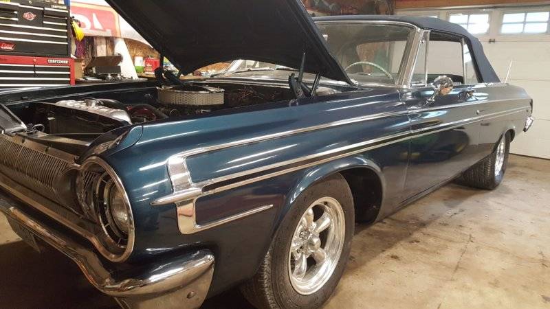

I bet you're having a hard time getting that smile off your face ! Lol
Just that car sitting in the garage would bring a smile...Man I love that blue.....Congrats on the drive!You bet! Relieved as it has been a long few months, mostly waiting on parts.
That's great! I'm excited for you. That makes me want to hear mine running.
That looks great Glen! What's the weather like up in your neck of the woods?

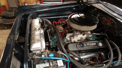

Can't seem to get it to keep cool. The underhood heat is MUCH better due to the headers and shroud, but it still creeps up too much, like 220F while idling in the shop. The timing should be right at 20 init and 34 all in with about 8-10 deg in the vac adv. Carb is tuned and I believe close with no soot out the pipes and plugs look good.
I think it is or was air locked. No flow after passing 195 with the 180 stat.
I pulled the rad to flush it just in case and pulled the high flow summit water pump to inspect the rotor, all is good. High flow 180 stat with bleeder hole tested fine which opens at 187. Wierd. Putting it back together tonight and will fill it again but jacked up this time. I think ghe fan is too far into the shroud though so I'm trying to find a 1/2" spacer. Anyone ever cut one?
