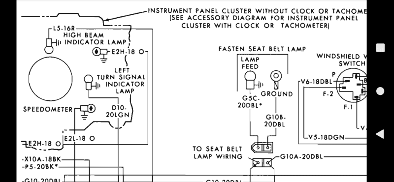

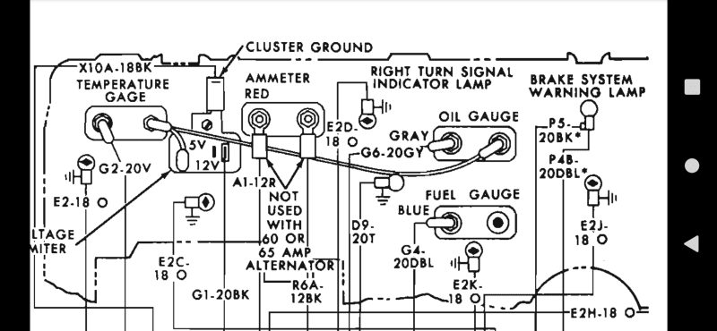

Can someone post a color wiring diagram for a 72 Satellite with Rally gauges?

I have a black and white one, but it's hard to read.
I really need the color for the wires for bulbs for turn signals, brake light, ect... for the instrument cluster.
Thanks!
I don't have them in color but I do have the manual downloaded on my phone in pdf so I can zoom.
Right ts - tan
Left ts - light green
High beam - red
Brake warning - dark blue and black
All illumination - orange
