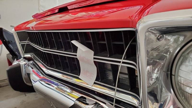

Here is a receipt stuck to my grille, I dropped it about 6 inches out and it got sucked in. You can see the hood isnt fully closed either. Now i guess this is the difference with heavy duty clutch that rotates at 70 to 90 percent of engine rpm versus 50 to 70 percent with standard duty.

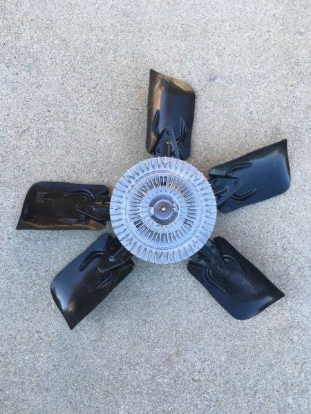

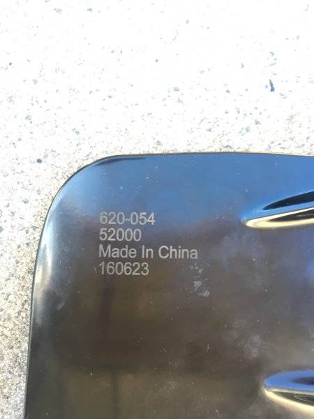

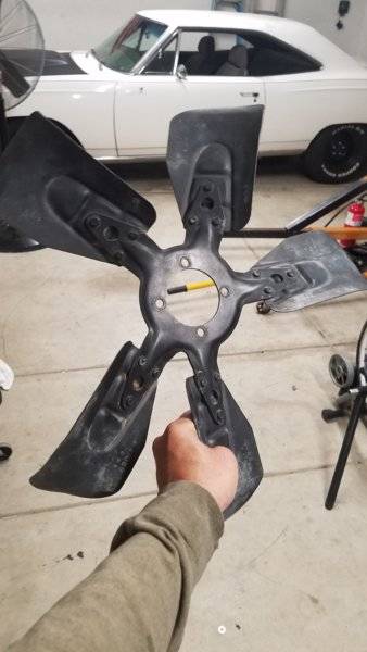

Interesting this thread came up. I am running a factory fixed fan with no clutch and wanted to swap to a clutch fan setup so I got the heavy duty Hayden 2947 with the short neck and also got a 5 blade mopar viscous fan recently. So I mount it all up and the paper suction test that worked before was now a no go. The fan was PUSHING air out the grill now instead of pulling. I thought I mounted the fan to the clutch backwards but as I flipped it around the blade pitch looked the same. I know my big block spins clockwise over the top towards the driver as you are facing the car and a small block spins counterclockwise. Are there designated opposite direction fan blade pitches for small block and big block? I thought the mopar viscous 5 blade was one fits all? Here’s a photo of my 5 blade fan that was pushing air.

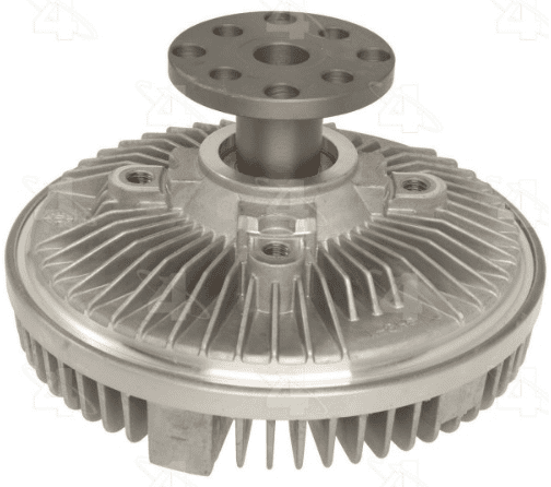

Well the unit I use is the Hayden 2797 severe duty clutch, it doesn't have slots.. It does have two drilled patterns so if you really look closely you'll see the dual pattern but looking at the edge of the clutch you don't see the obvious slots... Since I drive my cars allot it hot conditions I want the engine to stay cool & I want the A/C to work well so a severe duty clutch earns it's place in front of my engine....
View attachment 805524 View attachment 805525
Big Block & small block rotate the same direction, You have a reverse rotation fan from a late model vehicle with a serpentine belt.. And your spinning it in the standard rotation....

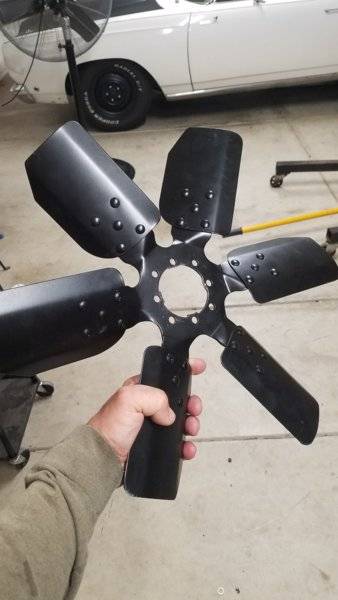

Yep that's for spinning the other direction. I have a Derale 6-blade, used it for about two weeks (until I came across an OE 7-blade that I'm still using).
The Derale is 18" diameter, a little heavier than the viscous units but it's yours if you want it..I also have a 20" (19-3/4" actual) 5-blade viscous fan that was off an RV if I remember...it's used but other than being a little dirty it's fine. It was a tad too big for my shroud. You can have either one, free, just p.m. me a shipping address if you're interested..
