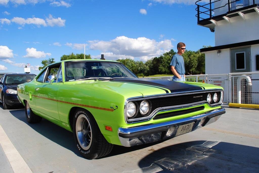

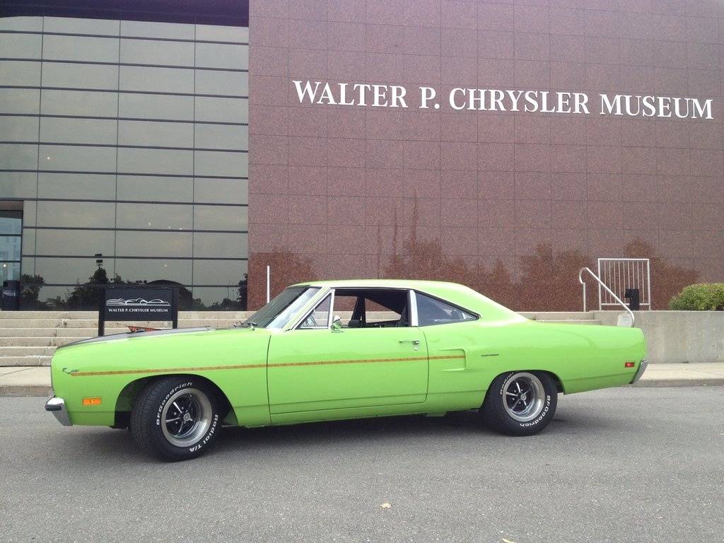

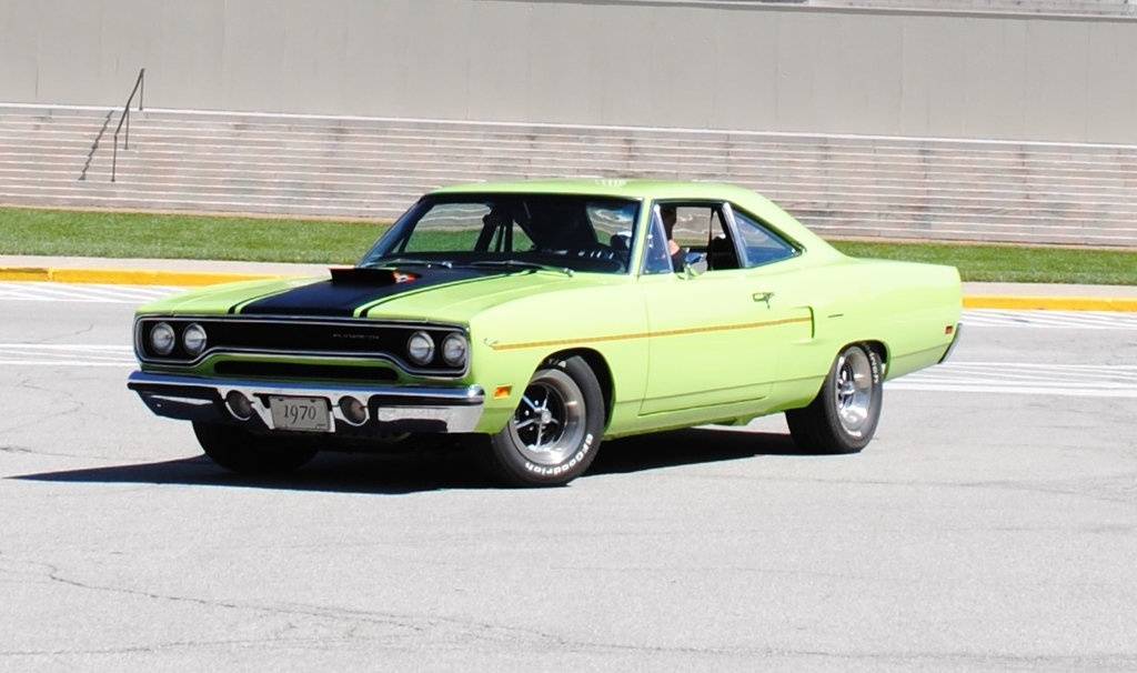

I have 245/60R15s on 8" rims up front. They fit and look great - a couple of pictures attached. No rubbing or issues of any kind. Sorry, Can't help you with 255s.

The rims on the front and back of my car are the same. They are 15" x 8" with a 4.5" backspace. Tires front are 245/60R15, rear 275/60R15.

Each person has their on preference on tire sizes, so I won't comment on my preferences. I listed my tire sizes above, and here is another picture of my car so folks can determine for themselves if they like it. Good luck with whatever final choice you make.
