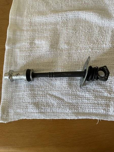

Replacing my brake master cylinder. When I removed the old one the pushrod would not release from the pistons. I got this left to remove but it won’t budge. Is there a trick to this?

Clamp it in a vice, the ROD. Leave just enough room for a pickle fork between the piston and rod. One wack ...

Clamp the rod in a vice with about 1/4 inch of space to the piston. 2 large screwdrivers one on each side and it will pop right off.
Thanks for all the advise. I do have a vice. Man it is in hard. All my other cars in the past the rod just slid out easily. Now I hope the bolts can be pounded out from the old MC

The "trick" was to pull it out while the master was still on the car. Do as Dadsbee says.
You can put that piston on a hard surface and whack it with a hammer, it will break.

I was able to pop the rod off using a vice and a big screwdriver pulling it upward. The old MC looks to have pressed in studs. I will probably have to order these. Hopefully I can carefully hammer them into the new MC
