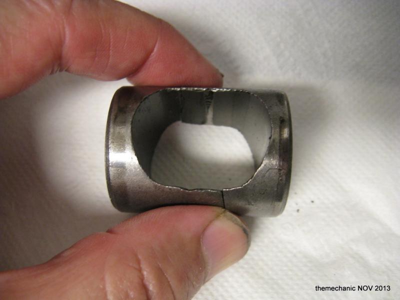

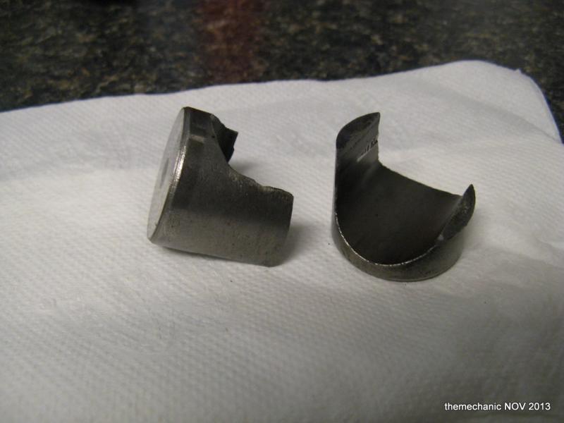

The thrust button could be lodged in there. Mine was broken in two and lying in the bottom of the housing but my axles came out easy.
See photo:
