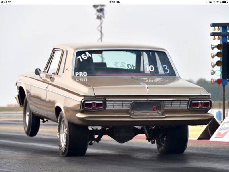

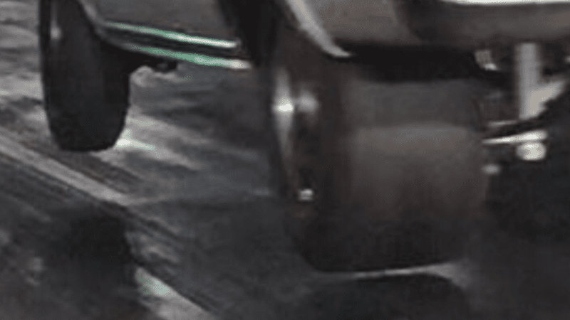

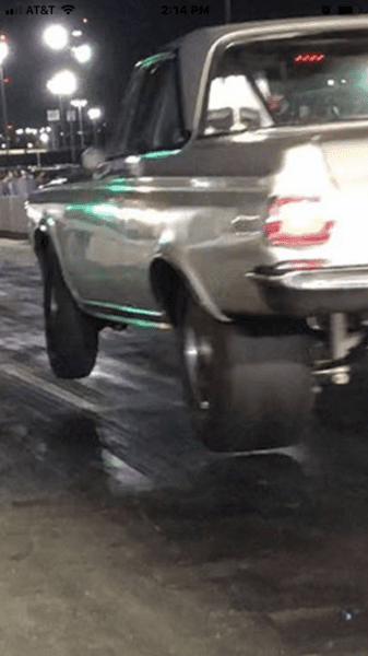

Man, been a long time since seeing a car do that lol. And if CT is recommending you put in 6-7 in the rears, I could rather go with that and then work down if it's too much. To me, that's being on the safe side of the pie and rather not break stuff stuff because things are still too loose.Tuning the suspension, & at launch the car literally jumps up lifting all four wheels, comes down then front wheels pop up to a wheelie.
View attachment 736557 View attachment 736558
