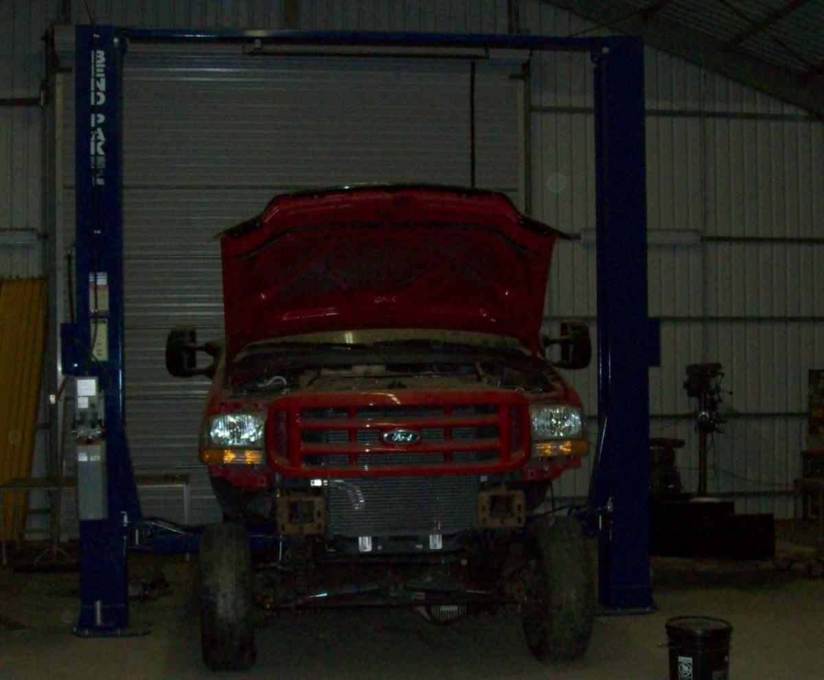

I got one and love it. I don't like the drive on kind as most of what I do is under or tires and brakes. If you got the room for it go big. Some trucks can be well over 6000 LB.
