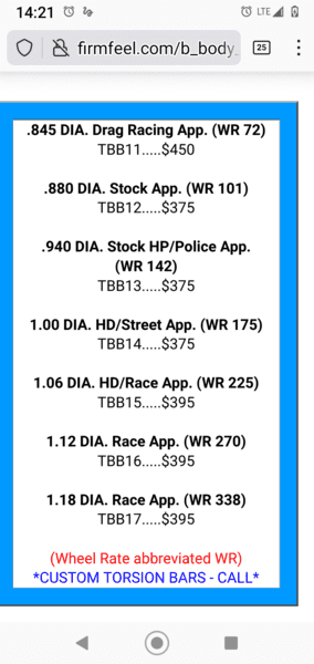

Check your torsion bar diameter too. If a 440 was swapped in place of a /6 or small block it may still have the t-bar for that. Here are the replacement bars available from firm feel, go with the hd/police for starters.
1 inch is the biggest I would go without corresponding increases at the rear of the car. Try to keep things 'even' front to back. Too stiff at the front and the car will plow. Too stiff at the rear and the back will try to swing around. You want to maintain balance.
Check your torsion bar diameter too. If a 440 was swapped in place of a /6 or small block it may still have the t-bar for that. Here are the replacement bars available from firm feel, go with the hd/police for starters. View attachment 1172901
