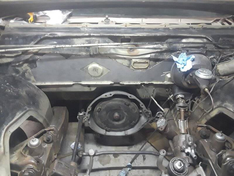

I run all of my cars like this with no heater or ac. I just cut a plate to block everything on the firewall.

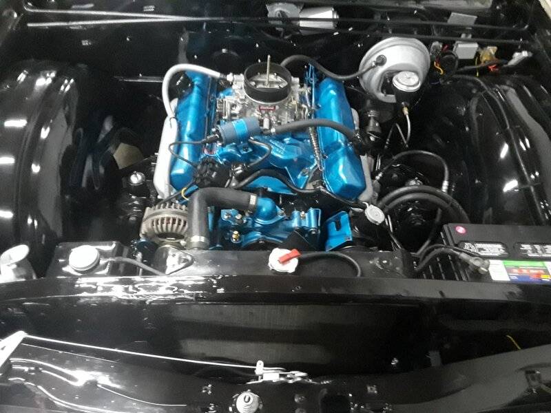

Since you have a B/RB engjne by your pix, the thermostat by-pass connection is below the t-stat as a cored passage in the water pump housing. You do not need to "loop" the hoses that normally that connect to the heater core. IF the engine was an LA design, a by-pass hose would connect the t-stat housing to the water pump. IF a heater core was connected, coolant circulates all the time. The air door in the heater box directs air thru the core resulting in hot air to the passenger compartment. Just my opinion of course.
