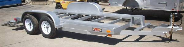

This open deck is priced fair. I'd consider something like this and buy some 16 ga steel to cover the middle.
Standard Features & Investment
Length Electric Brakes* Hydraulic Brakes*
CC 6.5 x 16' $3,078 $4,163
CC 6.5 x 18 $3,395 $4,480
CC 6.5 x 20 $3,715 $4,800
CC 6.5 x 22 $4,032 $5,117
Investment plus fees, see bottom of page*.
Standard Features:
  • 7,000lb GVWR
  • Two 3,500lb Axles with One Braking Axle
  • Equalizing Spring Suspension
  • 15" Tires / 5 on 5 Silver Wheels
  • 3 x 5 x 1/4 Angle Frame
  • 3 x 2 x 3/16 Angle Cross Members
  • 4" Channel Wrap Around Tongue
  • 4' Side Load Ramps & Storage
  • Open Pit with 24" 12 Gauge Steel Bed Runners
  • 4' Dove Tail
  • 2,000lb Top Wind Jack
  • 2-5/16" Coupler
  • 8 Tie Down Pockets
  • Overall Width 96"

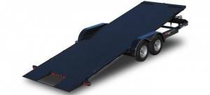

I bought a Kaufman 24’ tilt car trailer and love it. They are direct buy company so they will be cheaper to buy from them directly, but you will need a way to off load it. I had mine sent to my work and we used 2 forklifts to off load. When I bought it it out the the door was 4600. With delivery 2 years ago now with inflation they seem to went up to 5600 hundred with out the 600$ delivery i paid so who knows what it is. But worth the call and just to get quote if you have the means to off load. If u need u can always send it to your local trailer company with u small up charge. https://www.kaufmantrailers.com/car-trailers/tilt-car-trailer/8000-20-diamond-tilt-car/ This is the trailer i bought, again i found it was much cheaper to buy direct. Good luck
You'd probably need a 3/4 ton truck to haul that, right?
Copy and paste from the above link:
8,000 GVWR / 20 ft. Diamond Floor Tilt Car Trailer – DELUXE
Request a Quote
$5,590.00 Factory Direct
Our diamond floor tilt car trailers are manufactured with a rigid 5″ channel frame and tongue. The 8,000 GVWR model adds 4K axles with 225/75 R15 LRD radial tires. The entire bed tilts for loading and is built with all tubing steel construction. 24″ toe plates and the gradual loading angle, made possible by a total bed length (with toe plates) of 22′, make it possible to load sports cars with low clearance that will not load on standard ramp and dovetail car trailers. A hydraulic damper cushions the lowering of the bed during loading. Standard features on this high quality car trailer include a swing up jack, heavy duty diamond plate fenders, four-wheel brakes, radial tires, stake pockets with rub rail, and a sealed modular wiring harness with lifetime LED lights.

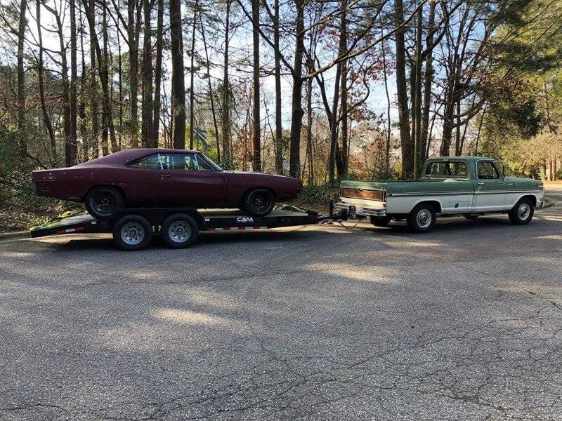

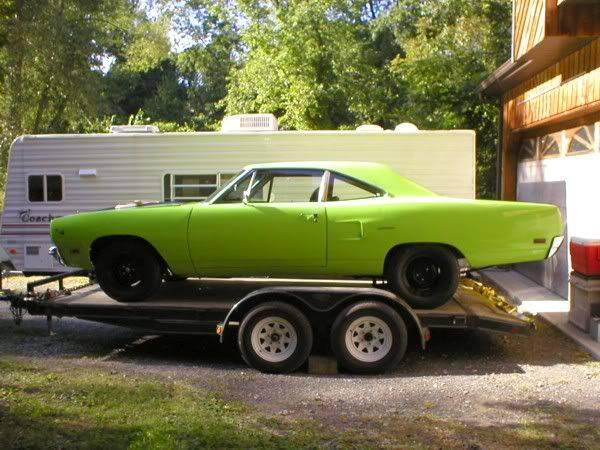

The Road Runner is sitting on a 16 foot trailer.
The Charger is on an 18 footer:
