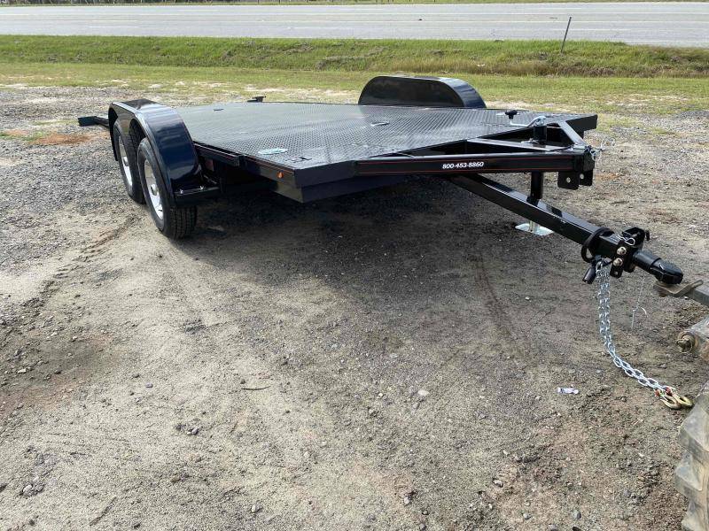

Looks like a nice trailer for the money.
Too bad the estimated delivery cost to the west coast is an additional $4000+.
(Kern could probably drive the 4600 mile roundtrip and pick it up, for about half that.) Thats why there seems to be a 50% premium on trailers on the west coast.

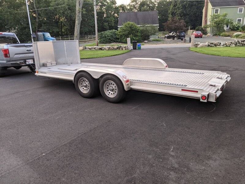

@mopar Tim has a reallly nice one
Quik load
https://www.kwikload.com/products/car-hauler/
