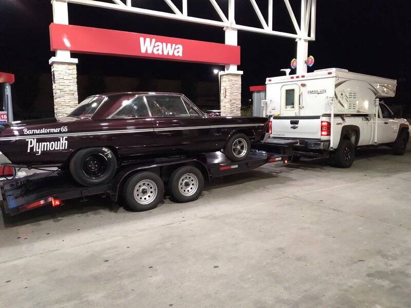

Wandering thru the pits at Irwindale last Thursday, the were four of those carsons in use.
I like both metal and wood decks. Wood eventually needs replacing, is the only real drawback. My trailer (the one that got stolen in 2015!) was a 16' wood deck with a 3' diamond-tread dovetail, for a 19' 3" total load area. Four "D"-rings plus the "C"-channel frame meant I could hook anywhere and tie down securely. Mine looked much like yours, other than the floor difference. Looks like you have a nice one.

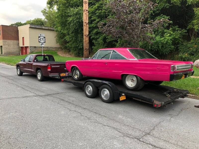

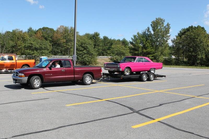

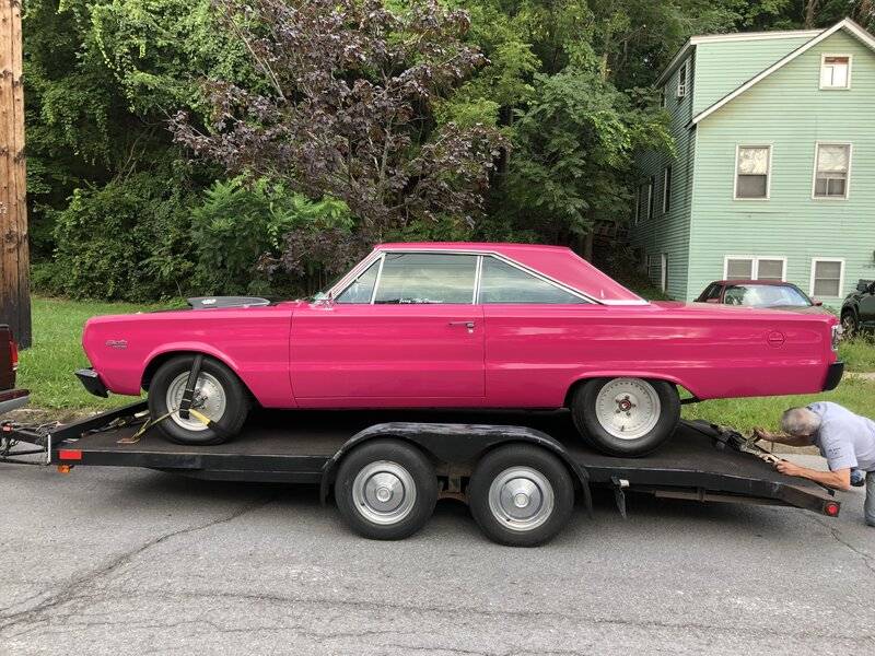

I bought a used 16 foot Master Tow, only paid $2000 for it. Have had it now 13 years. Absolutely no problems, Have pulled it at 75MPH w/66 on back. Remember 10% of weight should be on tongue, And get a weight distribution hitch!!! Aluminum trailers are great but big money. Probably x2 of steel. My deck is solid, did not want an open. I also bolted two 6 foot E-Tracks near the wheel wells so it can also be used as a utility trailer. Use to drive Semi in the lower 48 so have a lot of straps for that purpose. I get 14-15 at interstate speed 65-70 behind my Dakota.I'm looking to buy a car hauler trailer. I have a habit of finding derelict or classic cars and have rented dollies and trailers for far too long.

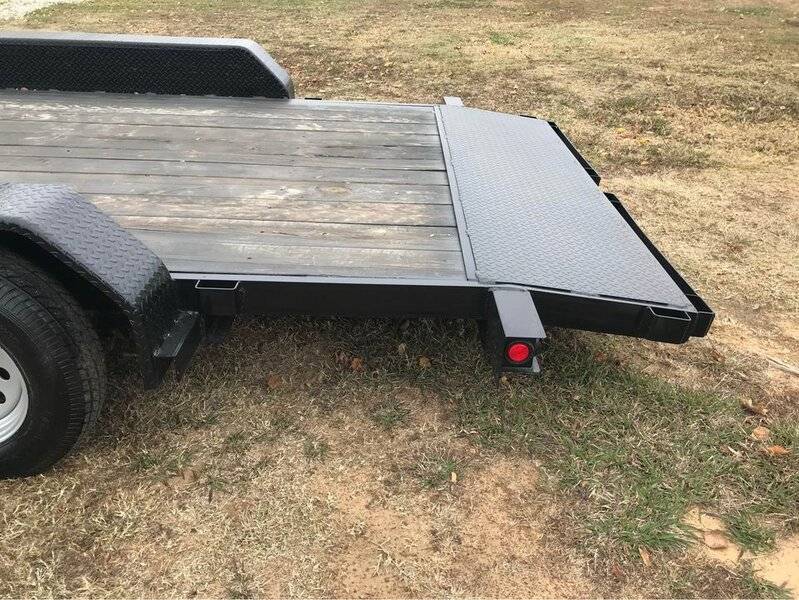

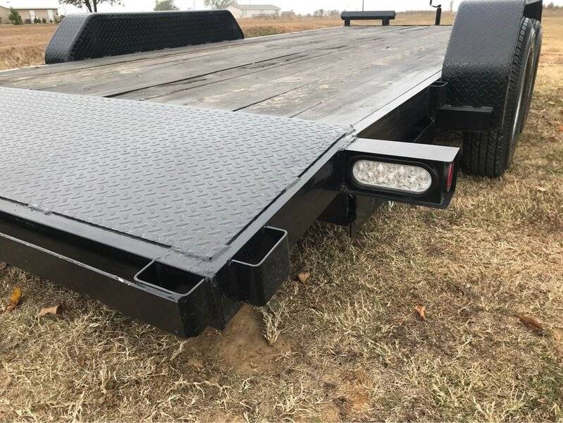

It's not mine I don't know what wood they used. If it's oak then it won't matter. It's a decent trailer for a decent price.Date of manufacture 7/2021 and the wood looks like this?
View attachment 1201124 View attachment 1201125
