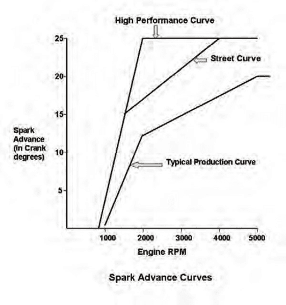

Mechanical advance adds additional timing to the engine and is based strictly on rpm. The mechanical advance weights and springs inside the distributor combine to produce a curve that begins with initial timing (with the engine at idle) and increases to a certain rpm, but generally peaks below 3,000 rpm. This is often referred to as the mechanical ignition curve.
Vacuum advance also adds timing to the engine, hut it is based on engine load and is controlled by intake manifold vacuum. When the throttle is partially open (highway cruising), manifold vacuum is high. This vacuum signal is routed to the distributor and "pulls" on the vacuum advance canister to create more ignition timing. As the throttle opening increases, load increases and manifold vacuum decreases. At wide open throttle (WOT), manifold vacuum is at or near zero and the vacuum advance produces no additional ignition timing.

Now that we know how these three systems work, let's look at a real-world example. Our fictitious engine is a small-block V-8, any V-8, but these variables interact the same with all engines. Let's give the motor 8 degrees of initial timing, as observed with a timing light. A test on the distributor machine reveals 28 crankshaft degrees of total mechanical advance (at 2,800 rpm) and another 14 degrees of vacuum advance. By adding all three values, we can see that at 2,800 rpm at light throttle (14 inches or more of manifold vacuum), the engine has 50 degrees of total ignition advance. At WOT at 2,800 rpm, however, the engine only has 36 degrees of total timing (50 degrees minus 14 of vacuum advance).
The photos illustrate how to go about moving the distributor and setting the initial timing. By applying a timing tape to the harmonic balancer, for example, you can set initial timing with a standard timing light and check total timing as well. To check only initial plus mechanical advance, disconnect the vacuum advance.
Total timing requirements are dependent upon many variables. A typical street engine with a compression ratio of 9.0:1 runs very well with around 36 degrees of timing (initial plus mechanical) for a rough total of 15-55 degrees of timing at light throttle when vacuum advance is employed. If the engine detonates or pings under WOT reduce the timing. If it surges or pings at part throttle, reduce the amount of vacuum advance. Experimentation with timing can help performance, driveability, and mileage by customizing the ignition curve to your particular application. Don't be afraid to make changes. HR

With the vehicle in operation, note the maximum amount of vaccum generated by the engine while in gear and being held at a steady speed between 2000 and 4000 RPM.
Stop the vehicle, turn off the engine and connect a timing light to the battery and number 1 spark plug wire.
Start the engine, and raise the idle to 2600 RPM. Connect a vaccum source (Mighty Vac) to the distributor's vaccum canister and draw vaccum up until to the reading noted in step b.
Note the total advance shown on the harmonic balancer.
Total advance, mechanical plus vaccum, should be set according to the following chart:
Engine Total Advance
A 50 BTDC
B/RB 56 BTDC
Hemi 53 BTDC
Disconnect the vaccum source and insert a 3/32" allen wrench into the internal vaccum canister adjustment screw. Turn the allen screw (clockwise to decrease, counterclockwise to increase) to obtain the correct setting. Reconnect the vaccum souce and recheck the timing. Continue repeating this procedure until the correct setting is obtained.
Remove the timing light and vaccum source. Reconnect the vaccum advance hose. Reset the idle speed to your original setting.

The problem with tuning for ignition timing @ 2500-3000 RPM is if the dizzy has factory springs in it, the mechanical advance will NOT be all in until 4000-4500 RPM. This is even more important when running more initial advance like most of do. This is a chart from the Mopar Engines book.
Always get your timing dialed in before messing with carb adjustments.
