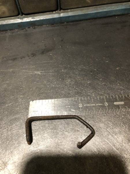

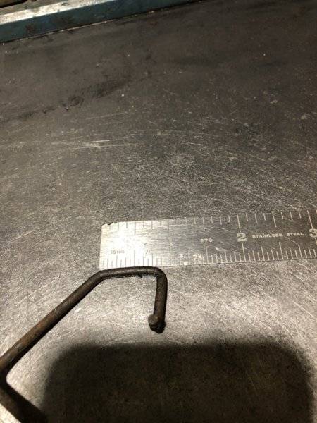

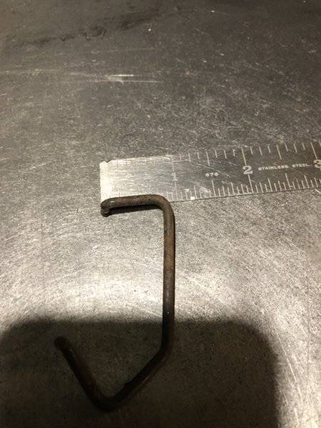

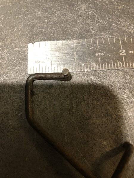

What is the chance that someone with a 71 AVS could take a few pictures for me with maybe some scale so I can fabricate the rod that I need ?
Hope this helps @Skytrooper
Yes it does !!! Thank you for doing that for me !! The link in the picture isnt available is it ? No problem if it isnt, I can fab one easily enough from your pictures.
Thanks again Dave !
No, I’m sorry. I don’t know where they all went to, but they seem to vanish and a lot of customers carbs come in missing one or the other or both, so I take them off my cores, and I can’t get them new anymore. So while you’re bending....... Mark me down for a couple dozen.:poke:

Dave, could I bother you for one more picture ? If you can, I need one with the straight edge across the throat with the scale showing the depth of the "C". I can pretty much easily determine all the rest of the dimensions. Thanks !
Matt
Matt, I’m not sure I have an AVS @ the house and the shop is 40 miles away. I’ll let you know if I come up with one before Monday.
It is not a big deal. I can get it pretty close by the pictures you already sent me
