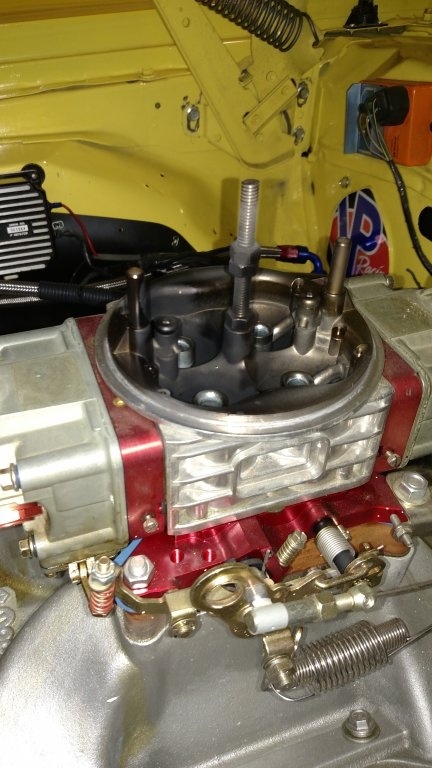

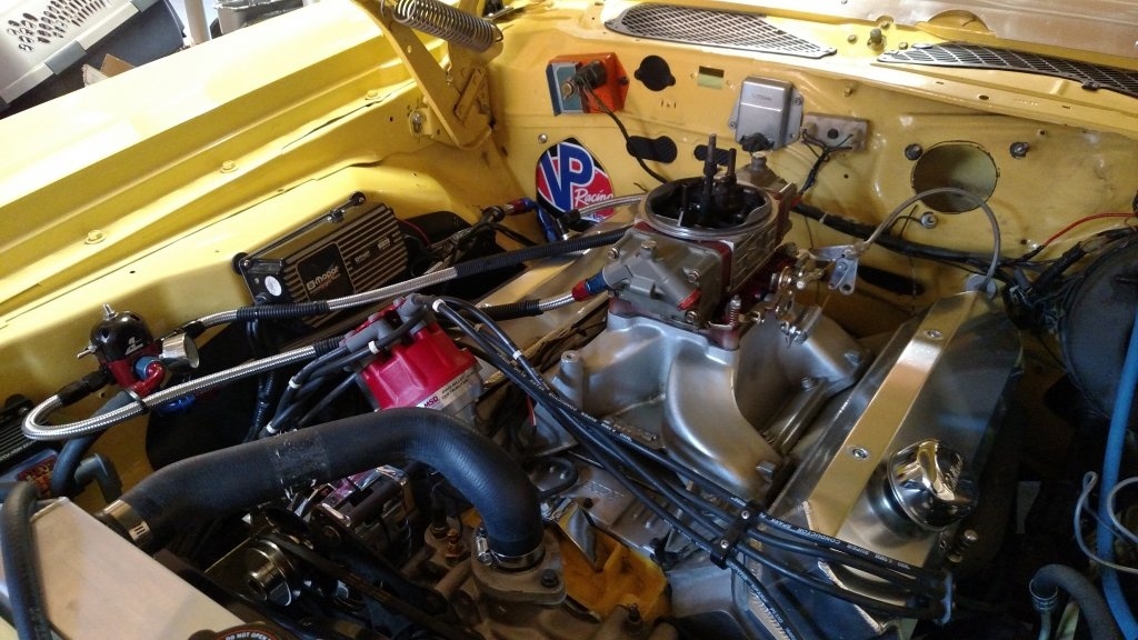

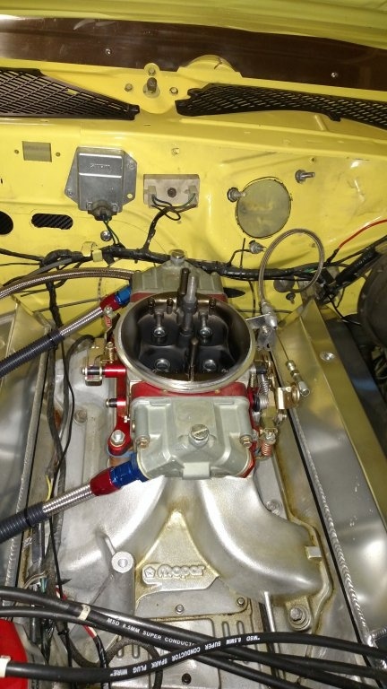

First off I will admit that I still have a lot to learn about carb tuning and plugs , I'm new to old school if that makes sense lol. Earlier today I sent some engine pics to my friend / mentor who's an old school racer and gives me a lot of tips / tricks of the trade. The first thing he said was nice bullet , then you need carb tunning. He said this just from seeing the pics of the engine and I guess the black in the venturi's. The car seems to run strong , although I have no idea how my gas milage is (nor do I care) . . So do it look like I'm running rich or does this little ok pretty normal? Also where would you start with tuning or diagnosing how it's running ? .. Also its a 1050 quick fuel . Thanks for the help!
BTW forgive me for the filthy engine pictures , still have to do a spring detail .

black in the venturis is a tune problem. i'll suspect that the engine has spit up thru the carb several times.
Probably a stupid question, but do I have to take it off to clean it or can I just use a rag and carb cleaner?

As long as it's not a build up you can just clean it in place, your just trying to see if it's still happening curently. I don't disagree that it wouldn't be better to remove it just not necessary for what your doing.
Yup, only when trying to start it though
that makes sense and i'd bet it's a cold start problem. a choke riches the fuel mix at start-up and you don't have one. this can create a lean condition and if the fuel level in the carb is down some you'll get a pop thru the carb creating the black soot/carbon. maybe a couple of extra pumps on the throttle and making sure the float levels are where they should be will help at start-up. also, the initial timing being slow can make the problem worse.

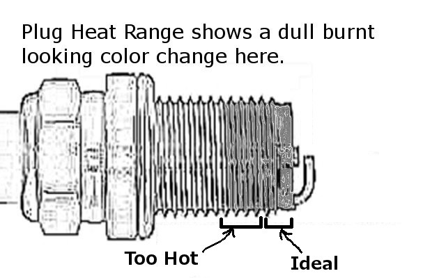

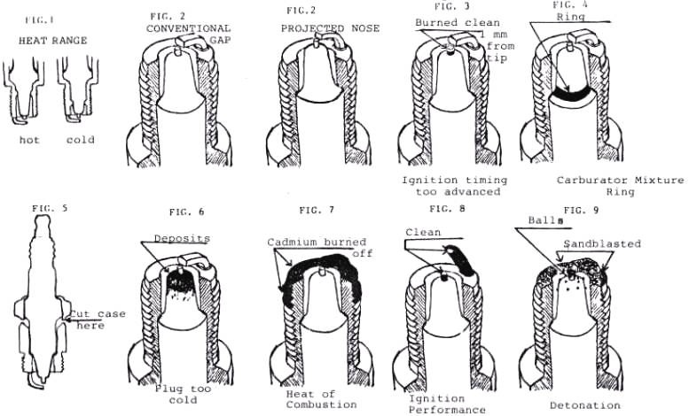

Have you read the plugs ?
What heat range are the plugs too ?
plugs "it's probably not cause of it",
but it helps to have the proper stuff to begin with
they will tell you if it's fat or lean etc.
