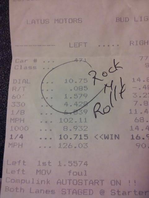

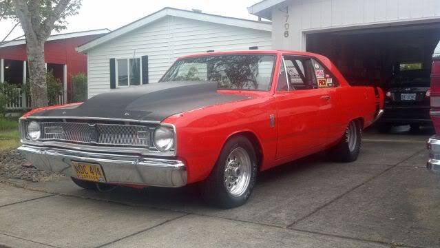

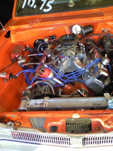

Run what you have.
67 Dart.
446 ci.
Hughs .590 cam
Eldelbrock heads ported.
M-1 intake.
3500 conveter.
Well built trans.
4.10 gears.
750 dp Holley.
Runs 10.71 in the 1/4. off the juice.
Very good street manners.
Forgot to say it's a Pump gas street driven car.
Yes I know I could go faster with a bigger carb.
But this one has GREAT street manners.
I don't know how fast you are running,but more people over carb there rides.
But 10.71 on street tire's and a 750 Holley.
This says a lot.
Maybe there's more in your tune
Just the fact's.LOL
If you show prof it leave little to the imagination.
This engine also has 11-1 comp.
