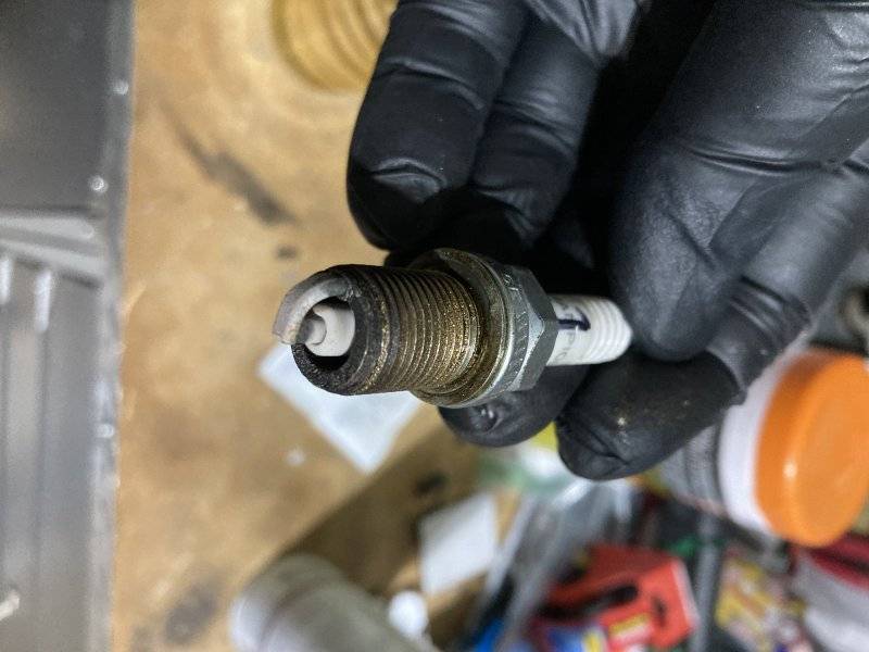

What metering rods and jets in your Edelbrock 1406 now
Thanks! So the 1406 is stock out of the box. Just going by their specs until I take it apart:
Metering Rods: .073 x .047 in
Primary Jet: 0.098
Secondary Jet: 0.095
I've included a pic of the #1 plug. The rest are very similar.
It is a stock 70 383 block with 440 Source Aluminum Sleath heads (2012 variety and no cracks that I can tell), Edelbrock DP4B intake, the cam info is below:
Thanks again!
A couple of corrections reqd.
[1] A lean mixture will burn your eyes. No it won't. Unburned fuel is what burns the eyes & this is commonly associated with cams having a lot of overlap. The mixture is contaminated with exh gas at lower speeds & doesn't fully combust. You are smelling unburnt fuel exiting the exh pipe.
[2] Rich cruise mixture can be caused by insufficient cruise timing. Often caused by the vac adv not working or has been disconnected. Cruise timing is usually in the 45-50* range but can be as high as 60* with a low compression engine with a 'hot' cam. With less than optimum timing, the engine is inefficient, requires more throttle opening. With optimum timing, less throttle opening is reqd & engine requires less fuel.
1406 - Electric choke
Confirm your electric choke is opening all the way once warmed up , at cruise
Total Timing is off
What Champion number plug s are you running

Choke is opening very quickly. I'll check the floats, etc soon.

Makes sense about large overlap cams. So even with a "perfect" tune, I'm just going to have a fair amount of unburned fuel at idle due to overlap. That does make sense.
I will check total timing again. Thanks!
I didn't really think that the cam profile was that far from a 70 383 Cam. More to look at. Thanks again!
