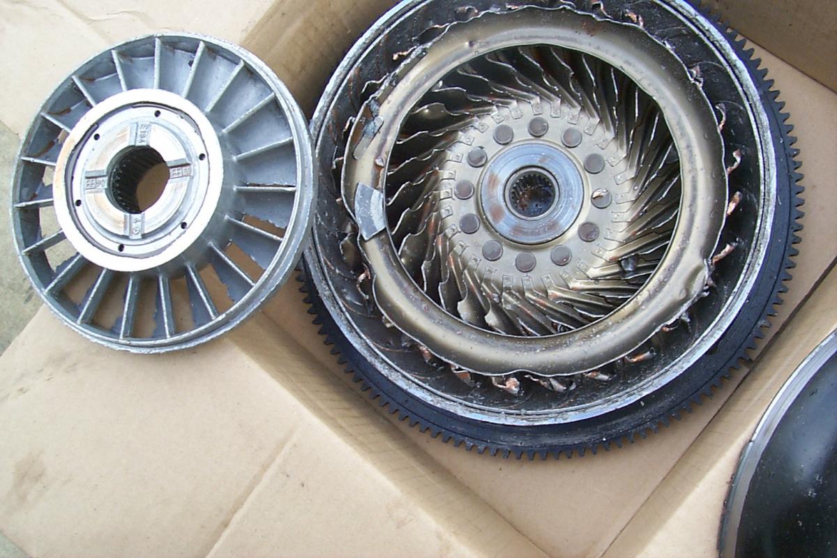

dead TCI Sizzler
Out of my Lil Red that is now in Australia (with a fresh trans and converter)
Anyone else have carnage to post????
Actually, the day before I had just resurrected the A/C on the truck. The day this happened I had stopped at a QT for gas. And as I was pulling out.......
buh-bye
You're not leaving anything out of this "gas and go" story are you...like a 5-grand neutral-drop or some serious Lil Red power-braking are you...???!!!
:grin:
Nope. not a thing. I hadn't even used it for any towing at that point. Was even before the "big move" to the country.
What probably happened was the lines and cooler weren't flushed when the trans was rebuilt some time before I bought it.
I had Phoenix build a new converter and do the trans. They also gave me a can of flush for the lines and cooler, and an inline filter so anything that didn't get flushed out wouldn't get flushed IN to the new trans.
