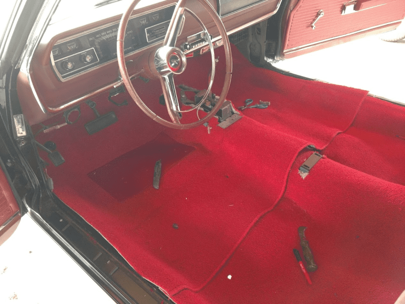

Who is the go-to company these days to get molded carpets from. The ACC carpet I just received has the heel pad in the wrong location.

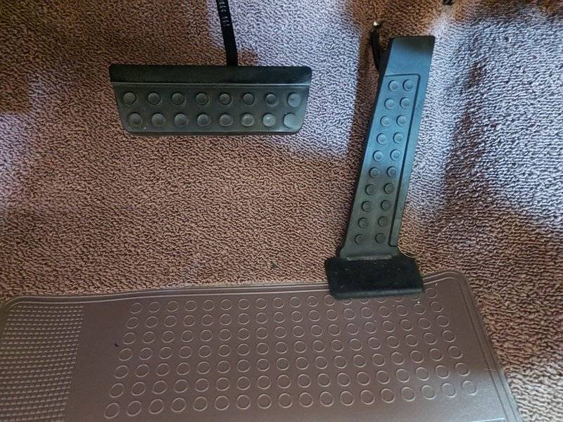

Here's where the gas pedal is placed on the factory B-body carpets....

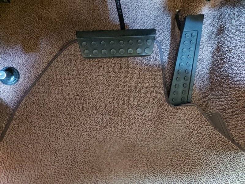

However, when I lay the ACC carpet in place, the heel pad will be in this location.....

When I install carpet, I cut the hole in the heel pad and work everything else from there. I have came up short on the drivers side before, but now try to order with extra width.

That's what I did, but there's no way it will line up with the factory holes in the floor. The carpet is tight into the 4-speed hump. It looks like the heel pad has to go 1" to the right & 2 1/2" up towards the firewall.

Sorry I don't have a good one with the gas pedal installed.
If you have a four speed without a console to hide the hole, you're limited to how much you can adjust the carpet.
I split the difference...

After cutting out the heel pad to match the factory carpet, this is where the gas pedal lands in the factory holes…..
Looks good to me. Most post I've seen on here about this very subject it doesn't always work out there. I cut the jute out also so it has a solid seat for the pedal.
Well nothing has changed then in 32 years. Right where my pedal is in both the Bee and the Bird. Bee installed in '88 Bird '90.
