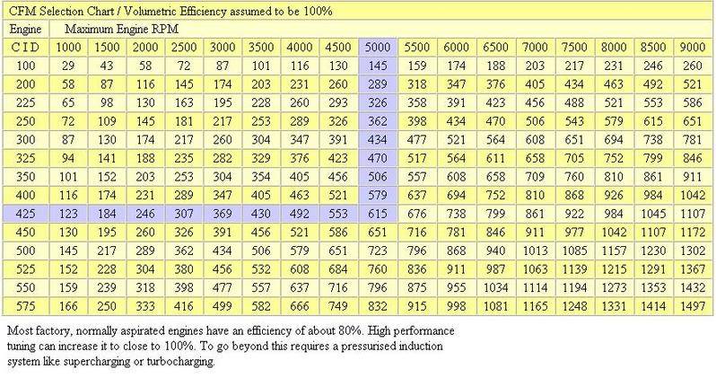

I've been trying to find a cfm chart or info on the Carter AFB carburetor. 1960 thru early 1970's. Most info is vague and it seems like any cfm readings are from someone doing a flow test on just a few models. Any info would be appreciated...
I don't believe there is such a chart. I think most 4bbl were rated at 670 "cfm"
most AFB's were 625 CFM...most AVS carbs were 650 cfm...I know of no "carb chart" that specifies CFM ratings

Thanks Pops. This is what I was thinking and what I needed!

Also note that Carter and Holley possibly rated their carbs differently. There is wet flow and dry flow and I think Carter used wet flow. The CFM rating on Carters from what I have known is about 570-585 for the 1-7/16" primary bores (340 and 383 carbs) and about 700 CFM for the 1-11/16" (440). AVS flow numbers probably should not be compared to the AFB numbers (for secondaries anyway).
