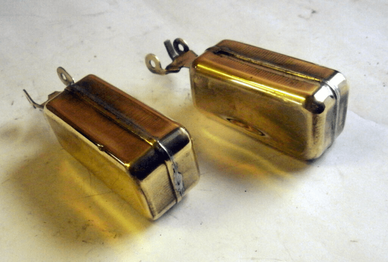

Funny you should ask, I came across this ebay listing, today, and thought of this post! $16+shipping seems a bargain, if you need these.
66 73 Mopar Brass Float Set Edlebrock Carter AFB AVS 4 bbl carbs | eBay

Scroll to the bottom pictures - Page 263 Brass Floats
You can see the difference between the two brass floats I mentioned - Size
Walker uses different part numbers in relation to Carter but it’s plain as day in the pictures
100-123
100-124
In relation to those Factory Carter Numbers I just listed above
Carter #21-241
340-383
Carter #21-245
440 HP
https://www.walkerproducts.com/wp-content/uploads/2020/05/floats.pdf
Original Cart AFBs for Mopar used the 21-179 Float ribbed side. Cadilliac and others used 21-188 smooth side. They have different area which would impact float level effect on the needle/seat.
Original AVS for Mopar used 21-241, 21-245. AVS are different then AFB.
Your model used the 21-245 float.
