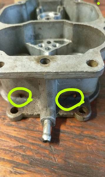

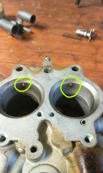

Hello, all. I rebuilt the Carter BBD on my '66 Belvedere II and it runs much better. Even though the accelerator pump squirt is still weak on one side, the car is noticeably peppier and snappier in response. This is a fantastic carburetor on this engine!
I'm very curious what these two holes leading into the carb throat are. Sure looks like 2 vacuum leaks to me ... should these be plugged?

Idle mixture bleeds?
Leave them alone! Needed for proper fuel distribution...

IMO...
These holes are Fuel vapor vents that were provided for possible relief of percolation issues. I'd just leave them ss you found them. FYI....there were 2 seperate models of Carter BBD (which stands for Ball and Ball Dual). The first was denoted 1 1/4" seties (which is what you have and is used on small block LA engines) and the 1 1/2" series which is used on the B series engines, 361s & 383s. You are correct they are OUTSTANDING in operation give decent fuel mileage, good performance, and are easy to understand and rebuild. They were generally used thru mid 70s when Carter went out of business and Mopar switched to Holley. Just my opinion of course.

Very cool, grateful for the info. Re: fuel percolation issues - what is the symptom of that were these holes not to be there?
My rule for "excessive vacuum leak" is if the idle mix screws cannot go so rich as to bog the engine. On this BBD, they can be adjusted "too rich," so the amount of vacuum leak caused by these holes is not a concern.

I believe, starting with the 1968 model year, more vehicle/engine combinations were using Mopar's CAP (Cleaner Air Package) and later CAS (Cleaner Air Systems) to control vehicle emissions of HC (Hydro Carbon) and CO (Carbon Monoxide).
For the smaller Carter BBD series, like yours, the idle mixture screws were pinned to keep them from being turned out too far. The mixture needles had a machined area on the threads and after setting them during manufacture, they were pinned to limit their travel. Perhaps, someone modified the carb to eliminate this feature or replaced the throttle body with one that was modified. Fuel mixtures were leaner as well. In addition, spark advance characteristics were modified to slowdown the rate of advance using lower initial advance but more total mechanical advance and sometimes adding a vacuum control valve on cars with standard transmissions and higher temp thermostats. All these changes resulted in hotter operating temperatures and during a hot soak restart condition, fuel percolation or boiling can occur, resulting in higher emissions, hence the need for additional vent passages to reduce this over rich condition. Today, this condition is exacerbated, by the Ethanol blended fuels that boil easier due to their lower vapor pressure index. Just thought you might like to know.....
