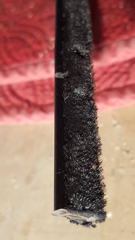

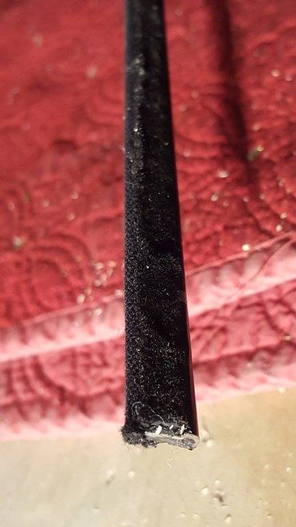

Upon removing the original fuzzies on the 65 Bel II, I noticed on the front passenger door the pronounced finished metal edge was up, and on the drivers door, it was down. I can install them either way . If you flip it over, more felt is exposed on the top edge. Is it more effective wiping one way over the other? Since the assembly line worker did not care..... should I?

Here are some pictures. Hope the difference is visible. Pic 1.. metal up.....pic 2.... fuzz up.
I believe the metal is supposed to be down and fuzzies up. Otherwise you see the white dots on the metal when installed.
That said, mine are on up side down. I painted the white dots black so that they were not as noticeable. I was not able to remove and the correct the new ones once installed without bending and damaging them, so I left as is.

The placement of the metal vs. the fabric side of the felt depends upon the year model and body type. For the car in question, I would say that the fabric side is visible. The markings are placed on the felts for the alignment of the clips.
