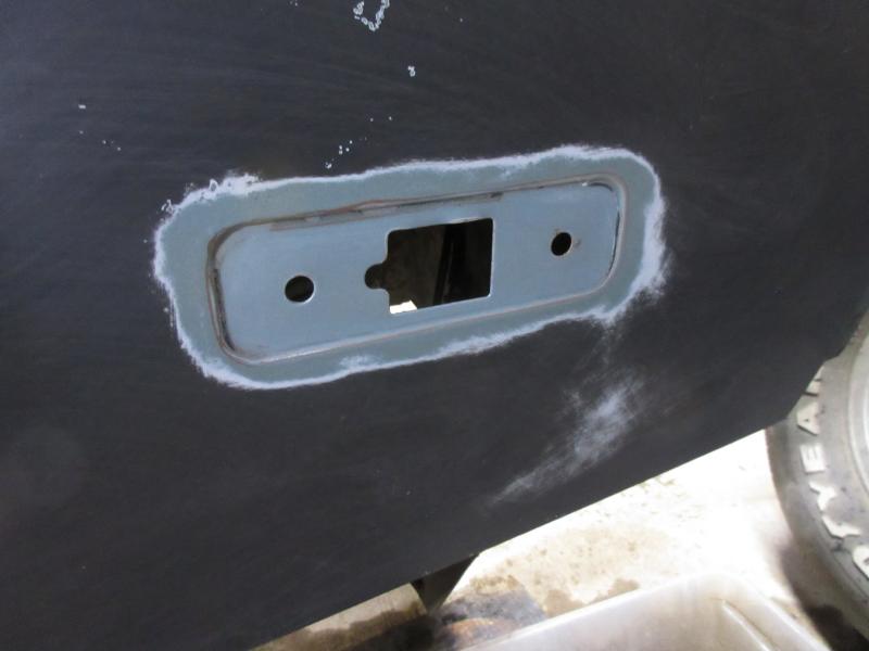

In all fairness to MAACO, the previous owner probably got what he paid for and more, because most of the paint is still on the car 30 years later. I'm hoping a lot of cutting and buffing and retouching will save most of it. Naturally MAACO masked off all the trim and things like this side marker lamp instead of removing them. I've sanded down the edge of their paint BUT I've tried this before and the edge of the MAACO paint job shows through my touch-up paint, no matter how much I try to blend it. Is there a way to make that edge disappear (short of media blasting the whole panel down to bare metal and starting over from scratch)?
Is that down to the metal? Hit the area with epoxy and then primer surfacer. Block sand it as flat as possible. The transition you have looks abrupt, that’s why it shows through.
Paint the patch area really thick and then sand it all back down level?
When that car was painted by MAACO they probably used Acrylic Enamel. It will lift at the edges
if you put anything "Hotter" over it. You can try a little epoxy primer over it because it's catalyzed
and hopefully will seal it off. Let it dry for a couple of days and then wet sand it with 600.

I'll see if I can manage a better transition. I thought that was pretty good but apparently not good enough!

Your paint edge is way to sharp, needs feathered out 4 to 6 inchs more from the edge you now have with 320/400.
Primed and sanded 400 again , sealed , color blend into 800 grit finish on the surrounding area.
If you are wanting to keep your repair area small and/or take the lazy way out, a finishing glaze (USC Icing) would give you some more build than putting thick primer on that area. The glaze will adhere well to a properly sanded surface and would easily build up to the level of the existing paint, then spot prime with epoxy and paint.
I've got some Upol Gold Glaze from last year. Probably still good?

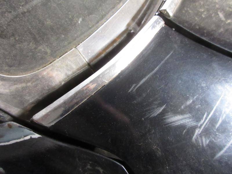

How does this piece of trim come off? I've felt around behind it, but nothing's jumping out at me.

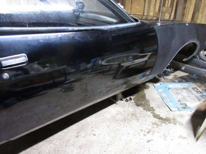

Most of the door buffed out surprisingly well. It's not show quality paint, and there are a few door dings and other minor scrapes, but it will do.
