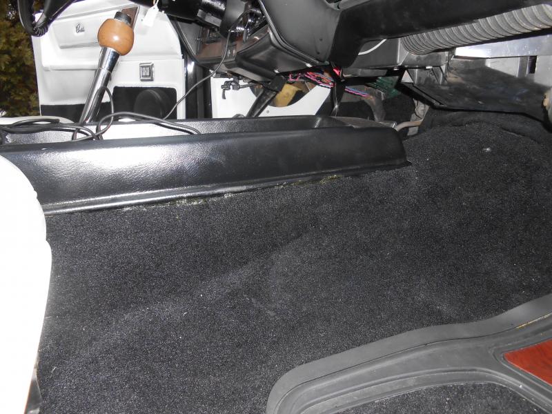

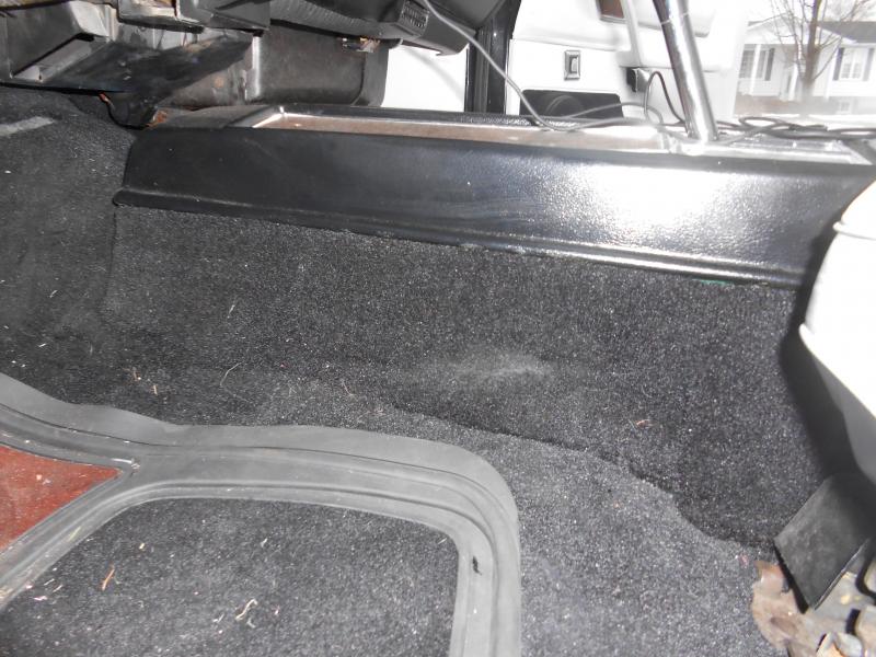

I refurbished a centre console. Cigarette burns in the tray were repaired by a guy that does custom work for boats to make smooth. I then repainted the whole console with vinyl paint. Put new carpet in car including the skirt for the console and the doors. Used double sided tape initially but it didn't hold in the summer heat. Reattached skirt and door inserts with a glue used by custom radio shops. Was put onto this when I had speakers mounted in the door. Sorry but I don't have a brand name for you.

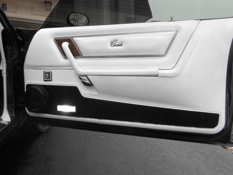

Here are some pics. Is better than it looks in photos as car is in storage and somewhat dusty. Car originally had a green interior. When I ordered the new carpet, I ordered an extra yard of the some material for the door inserts and skirt for the console. I used the old material as a pattern when I cut the material to fit. Glue is applied to the console flange only and rests over the floor carpet.
Those door panels are beautiful! Did you just dye them? Or change em out?

The original car was green with a white interior. The door panels were white, I took them apart and repainted the white pieces with white vinyl paint. There is much more info on this thread. http://www.forbbodiesonly.com/moparforum/showthread.php?54856-My-New-Doba/page3
