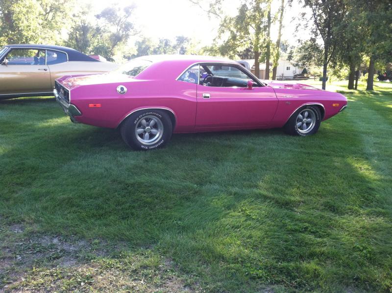

The Centerforce Dual Friction is the best clutch I've ever owned. I removed the over center spring, other than taht the linkage is factory. Pedal has less pressure than stock. It never shudders,slip,chatters. Over 100 drag strip passes with slicks. Pedal never sticks to the floor. Stock 23 spline power shifts flawlessly. I would buy another in a heart beat. The car is a small block Challenger running mid 12s.
Doug
