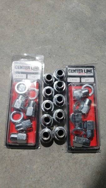

Looking for two packages of Centerline L-5110 lug nuts. These are the 1/2" open ended ones for Convo Pro wheels.
Some of the lug nuts just have pressed in caps. I used those back in the day on my 3" studs just kept threading them on and they pushed out.
The L- 5110's are 1/2 x 20 right hand thread. Shank is 1/2" long, and hex is 13/16"

I have two packs of Centerline L-5110's and the shank diameters measure .643 and fit the Convo Pro wheels perfectly. I found a later produced pack that measure .648 and are very tight (quality control issue?) The shank lengths all measure .490 so no problem there.
I did try a set of McGard, but the shank diameter is .640 and these are sloppy loose.
Thanks for the replies.
I`VE RUN INTO THE SAME THING, I TAKE THEM DOWN IN A LATHE IF TOO BIG------
