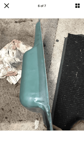

CenterLink Rubbing on Oil Pan
I know you are down under so parts may be a problem. Mancini Racing has engine mount shims in various sizes that will correct your problem. This would be after you check the condition of the engine mounts.Even new engine mounts vary in thickness do to poor manufacturing tolerances.I purchased my shim kits from Schumacher years ago. I understand they are no longer in business.

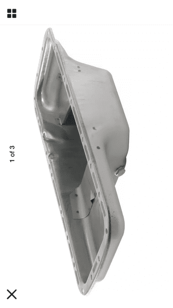

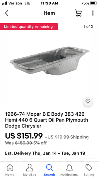

I think it’s your pan the factory pan is a lot thinner you can get higher capacity pans made correctly that one is just not for a 68 69 roadrunner
