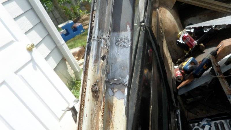

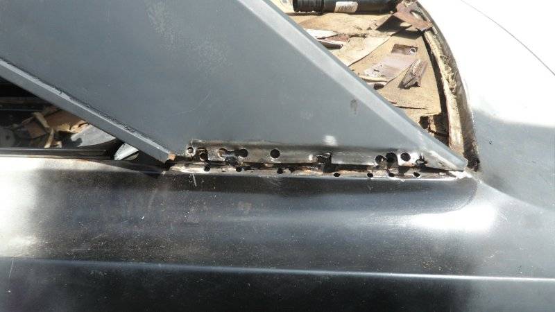

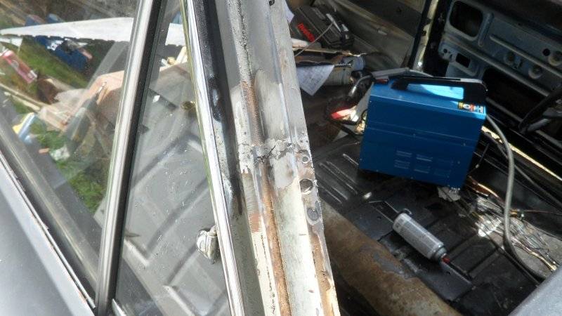

I changed the entire roof and sail panels on my 67 Belle. I actually had a great time doing it. Even though I had a cheap old harbor freight welder at the time. I actually I think its weakness was the best asset. It didn't blow through sheet metal like my Lincoln 140. Donor roof came from a poor 1967 Coronet that was headed to the scrap yard. Paid the guy 200 bucks for the roof and about 50 bucks in sawzall blades.
WHen I cut the front pillars I used a little notch that was in the pillar as a reference point. Then I cut the pillar and L notched it so I would have more surface to weld. I guess I could have cut it straight but I liked the fact that I had more area to weld. This is sort of what my notch looked like.

The notch on A pillar is a great tip. I was thinking of putting inner sleeve in it as well and plug welding it.

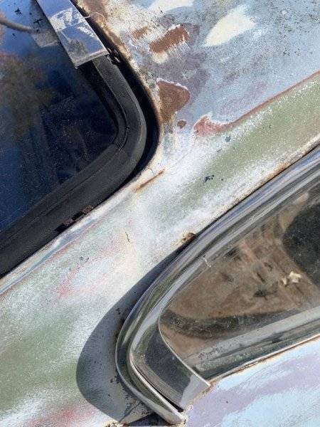

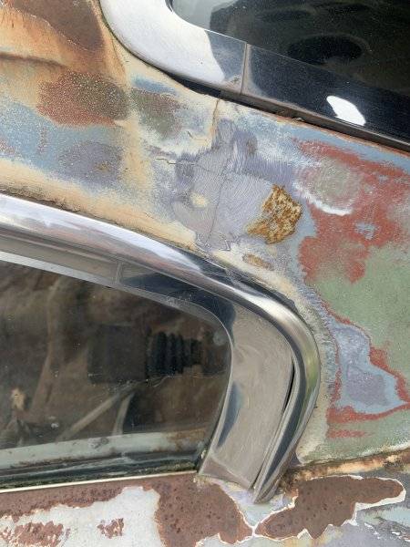

What would you guys do with this C pillar. It’s only about 4 inches wide and appears to have complicated inner structure
Thanks for the responses.
Looks like there is a seam down low. Can you take a better picture of this area? inside and out if you don't have a head liner in.
Depends on the rust.
I depends on the shape of the inner structure as to how I proceeded. If it is only partially rusted in places I would scab in new metal. If it is rusty all over a complete renewal would be better. But I would at least remove the original skin first to survey the damage.

Here are some pics of the C Pilar
The seam is in the crack of the lead spot. There is an inner structure.

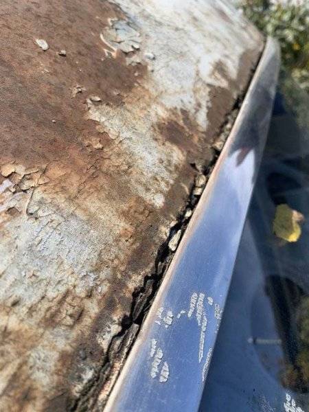

The rust is all along the top of window at rubber seal
Goes all the way across.
In front also at top of windshield.
The sides look pretty good.
I think I after I remove windows I will know more about what I’m dealing with.

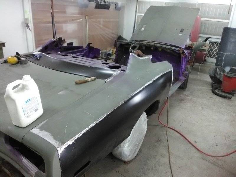

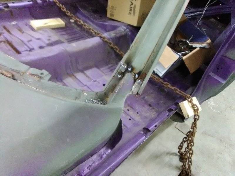

That's how I did the roof on my Charger. I took it apart at the factory seams in the rear and cut the front pillars in the middle, I just left a 1/16" gap in the front so it's welded full depth. You could do the front at the factory seam as well but my donor roof didn't include that much.
