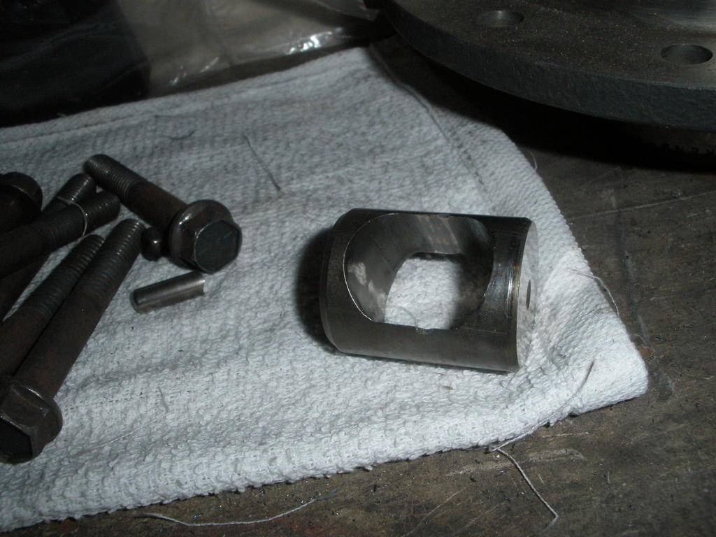

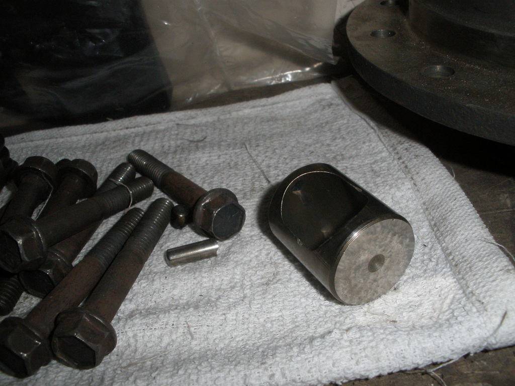

The "steel plate" you are referring to is actually made up of two pieces with a small diameter hole thru both. They are held together with a small rolled pin. Drive the pin out to remove them. (the pin runs parallel with the axles)

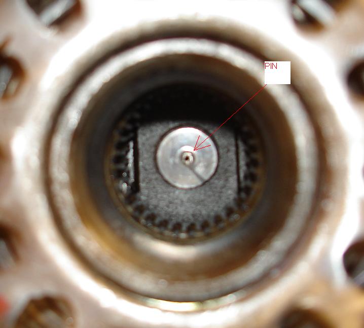

I assumed you have a early Spicer SureGrip Posi. If yours looks like this pic my instructions are correct. Look in thru the side gears(where the axle slides in) you should see a button about 3/4" diameter with about a 1/8" hole in the center. That is where the pin is.
Couldn't leave you hanging. Went to garage and took another pic. If you have a Spicer SureGrip you should see this. If you can't see pin hole it could be filled with gunk.Pin.JPG
Couldn't leave you hanging. Went to garage and took another pic. If you have a Spicer SureGrip you should see this. If you can't see pin hole it could be filled with gunk.View attachment 147456
Great posts, sam. I noticed you were new to the forum. Welcome, thanks for sharing your knowledge.

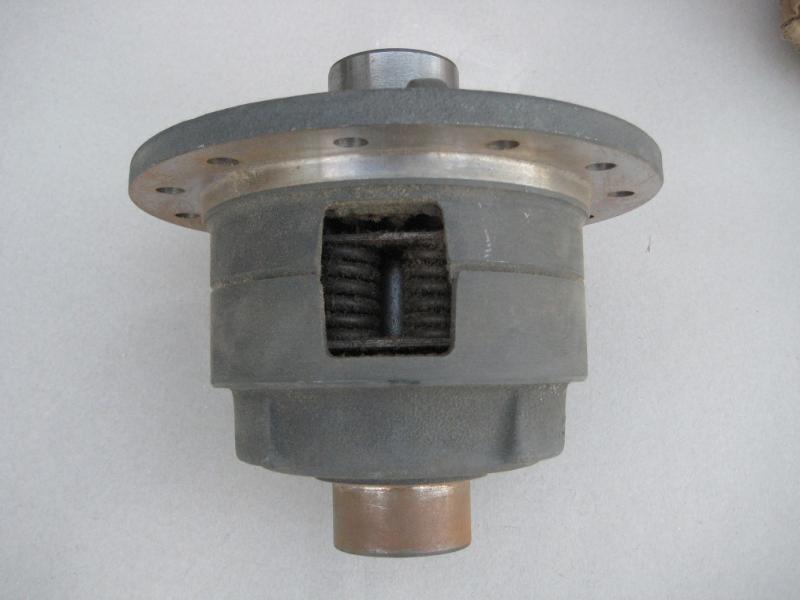

Is your Posi made in two pieces and bolted together like the one in my pic, or is it all one piece?
Well, I still can't upload pictures, but I do see that my center section is one piece and there does not appear to be any kind of pin in the middle of the spacer. I'm lost here.
I can email my pictures to anybody who is willing to help me here!! That would be no problem.
I believe that's it. And from what I've read on this forum and on other forums here on the good old World Wide Web, this type of pumpkin must be disassembled to remove the spacer. The only other option is to shorten the axles slightly.
