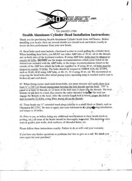

I think you would fine doing them one at a time but use the torque specs for the head, not ARP.
Uh oh!!! It's been so long, I do not remember if I used the instructions for the heads or not. I may be pulling valve covers on both sides. Ugh!!! Also means readjusting all the rocker arms. I guess this is going to be a long process.
