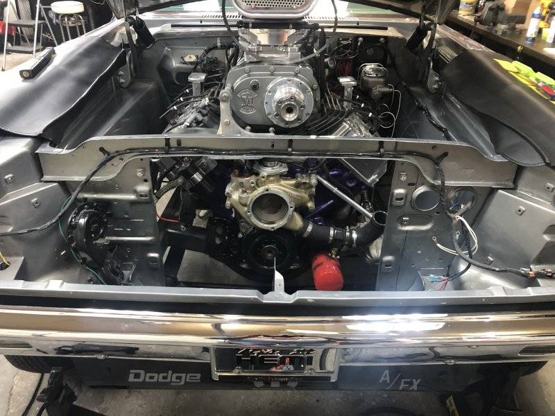

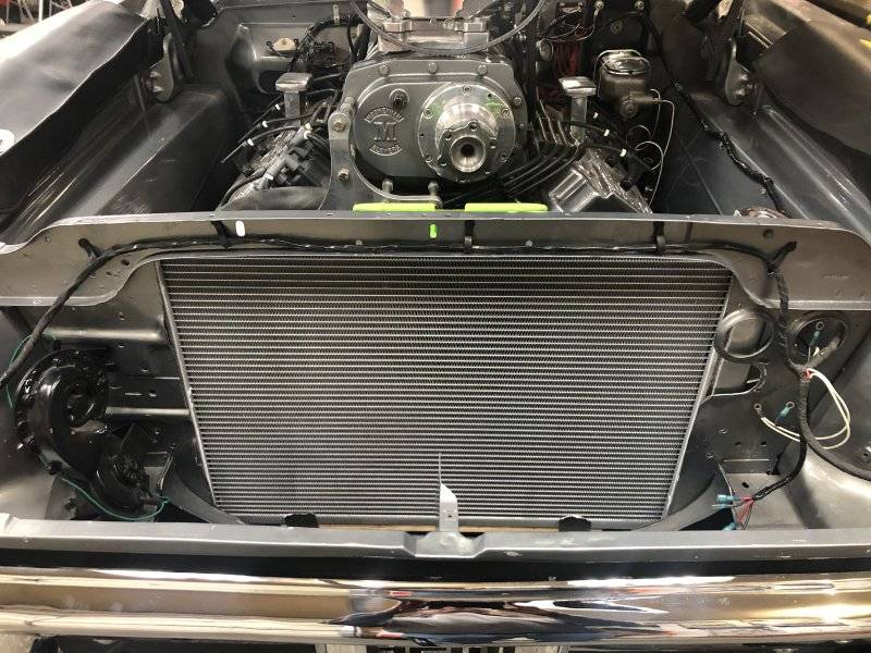

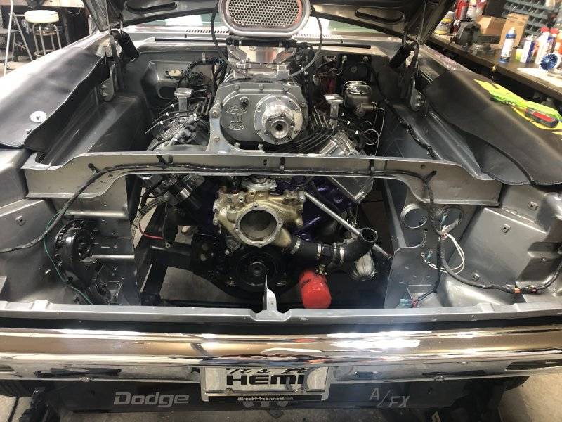

I know this isn’t for everybody, but I cut out the support to put this massive 28” triple pass in to keep the blown Hemi cool on the street, I even had to grind the frame rails and no way it would of happened if the battery wasn’t in the trunk.
Has 2 pushers hooked sequentiality, into the sniper computer and works fantastic, I think I could add A/C!
Has 2 pushers hooked sequentiality, into the sniper computer and works fantastic, I think I could add A/C!View attachment 1530812View attachment 1530816View attachment 1530818
