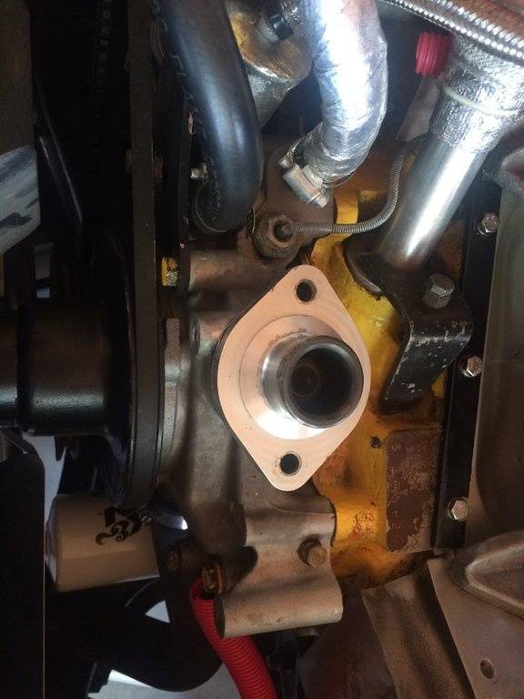

Trying to change thermostat but housing is stuck to water pump pretty good. Any tricks or ideas how to get it loose without breaking it? Any help would be appreciated.
Cheers
Lightly tap a thin, flat putty knife between the housing and the water pump to free it up...

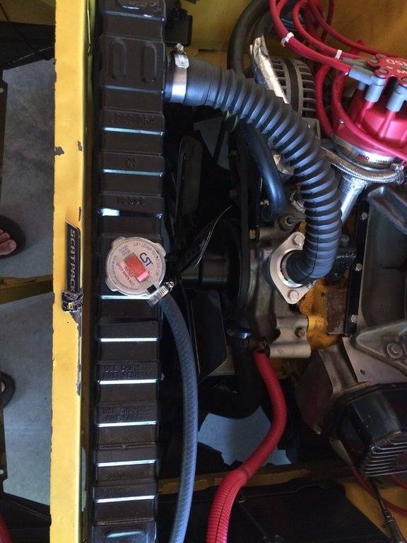

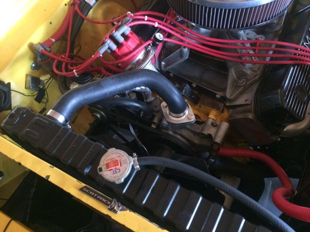

Thanks for the advice. It's all back together. Here's a pic. I'll take it for a rip tomorrow. Hopefully it all sealed good.
Started filling rad slowly. Drain is snug but fluid started coming out. Any ideas? It was ok before I loosened it to drain.
Out of curiosity did you use gasket sealer on your thermostat housing?
Open the petcock completely, then close again. I use a pair of pliers to turn it a "LITTLE" more than hand tight. Good luck...
Yes I did. It sealed great. No leaks. Took it out tonight for a drive. I ended up putting a new butterfly drain plug in. All good now. Thanks.
The reason I asked, I don't use sealant with the Fel-Pro gasket, never had a leak.
